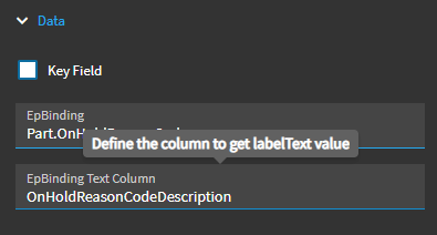

What about the EpBinding Text Column?
Bind it to wherever you want to save that value. I’m not sure how well it works with actual saved data - my example uses a dynamic column that only exists while the page is active…

It stuck it in the same dataview as the main EpBinding. In this case, in the Part dataview
I was wondering about that field. I’m not sure exactly how to use it. I’d expect to set the EpBinding to Transview.myRevDesc. But that didn’t work on its own. I still have an event in place to update Transview.myRevDesc onBlur of the combo box. But my row-update is not generating a valid value with the expression. So I removed that event entirely. And That seems to have done it! Now my Transview field has the correct data. Perfect! Thanks!
