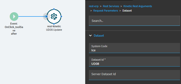

Event > After > OnClick_toolSave
This should result in the base “Save” event firing (which will update the base data via the NonConfSvc.Update method) and then it will fire your event where you can save/update data to the UD08 table.

As David stated, you can create a custom event after that OnClick_toolSave (which calls NonConf.Update()) to call your UD table update.

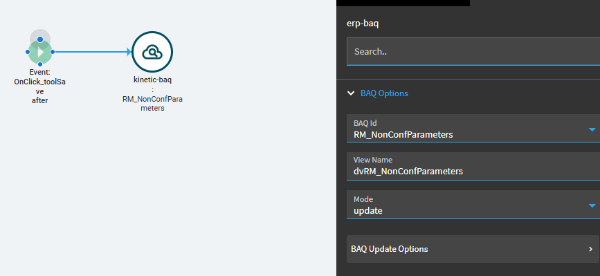

After creating the after OnClick_toolSave event, I used rest-kinetic with Ice.BO.UD08Svc and tried setting parameter dataset with my DataView’s name or UD08 itself, both with no luck. But, I finally get that blue loading bar, but nothing actually saves. I found another user using Kinetic-baq instead, so I went to give that a shot. The following screenshot is that:
Maybe I need a row-update in there? I’m not 100% sure. I feel like I am missing something right in front of me, I am just getting thrown for a loop because I am not used to a visual editor like Application Studio. Thank you guys for the help, it is greatly appreciated.

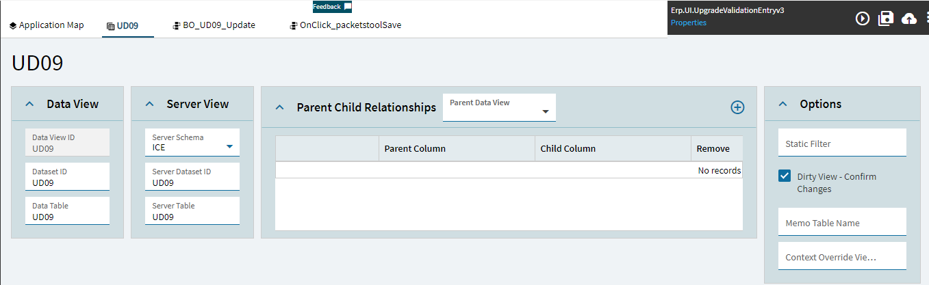

Hello, here is a working example:
Data Table:
Save event: (there is no trigger because this is called from a control)
It should be as simple as setting up few fields as seen in these images.
Are you sure the fields you created/added are setup correctly?
Let me know if this fixes it.
Edit: A bit more advanced, but an alternative method to doing this is using Epicor Functions. You could create a function that handles the update by creating an event in Application Studio, passing the TranID to the Function and the data to update, then in the function do a GetByID on UD08 WHERE Key1 (or whatever field you are storing that field on) == the passed parameter. Next, update the dataset with your changes, then, call UD08.Update()

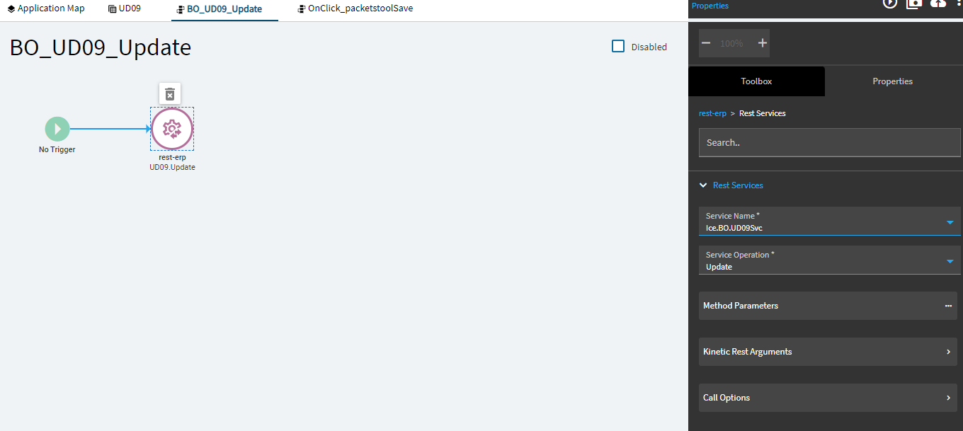

Sure -

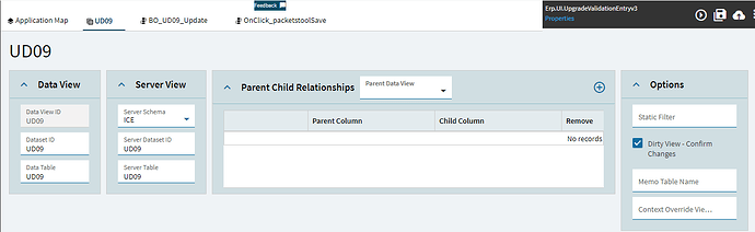

I am calling the data from the UD table into a DataView, shown below

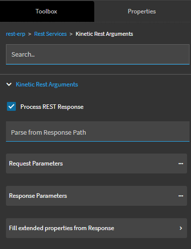

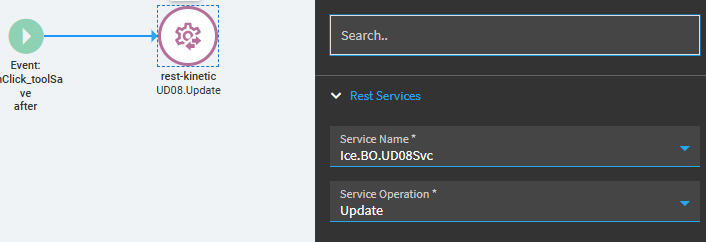

After the trigger David mentioned, I have this under rest services under rest-kinetic:

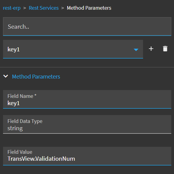

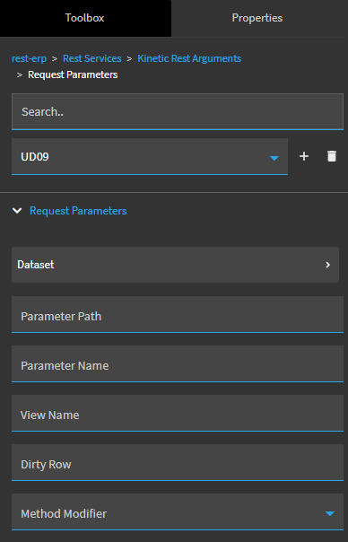

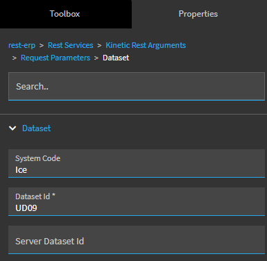

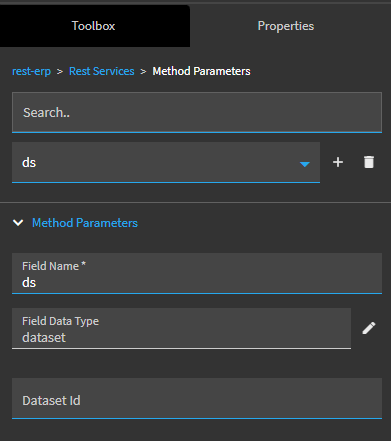

Under that, under Method Parameters, I have exactly what you have (ds and no Dataset ID)

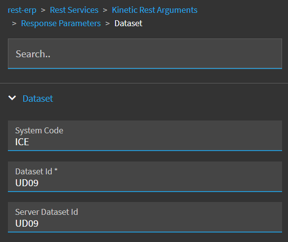

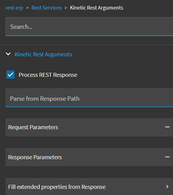

Under Rest Arguments, Under Request Parameters -

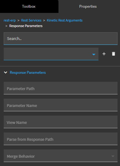

and under Response Parameters I have nothing

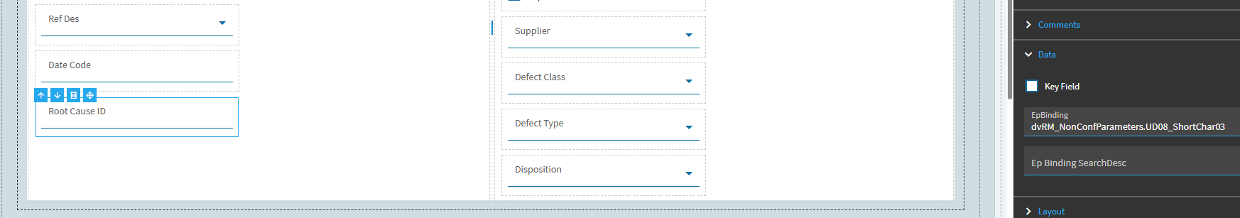

Maybe it has something to do with my DataView being dvRM_NonConfParameters instead of UD08? I was only able to get data to fill in the parameter by using dvRM_Non… BAQ with UD08 linked as the only table in the BAQ because when I use UD08 by itself, data doesn’t even fill.

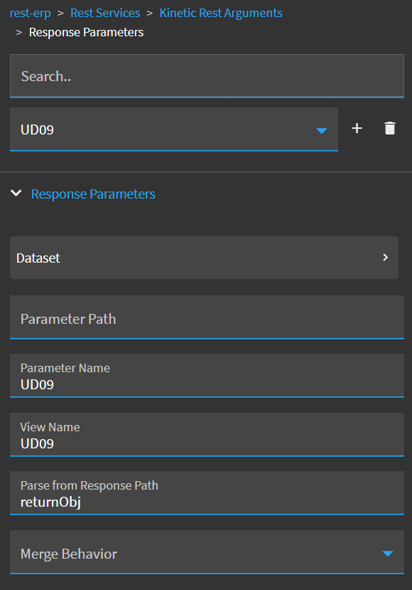

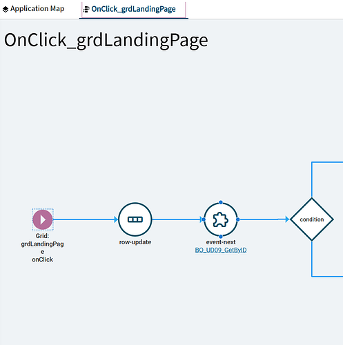

Here’s an example of how to populate that dataview:
Your parameter to pass to the GetByID is just the TranID if that is what you are using as the Key for your UD08.
These screenshots should get you populating data into your UD08 table correctly. I believe your problem is you are just populating your data fields, then calling UD08.Update(), but it doesn’t know what record to update, because you aren’t getting the required fields to do so. This should get your dataview populating correctly, so the update works as intended.

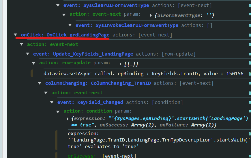

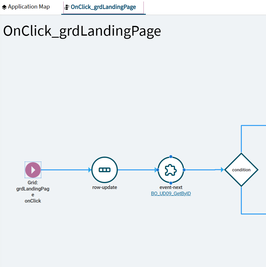

There is going to be an event under Events → Components → Grid. What this does, is on click on a NonConf TranID, populate all of the dataviews. That is why you see data when you click a record.
Your trigger will be after the "OnClick_grdLandingPage. Here, you will insert that logic I provided above to populate your dataview. Then, your update should work as intended. Feel free to remove that BAQ you are using to fill the table currently, as this should cover tha.
Additional tips, if you go into the chrome dev tools (F12), enable debugging (ctrl + alt + 8), you can see all the events firing to know where to place your trigger. On top of that, you can see all of the dataviews, and their data, by pressing ctrl + alt + v.

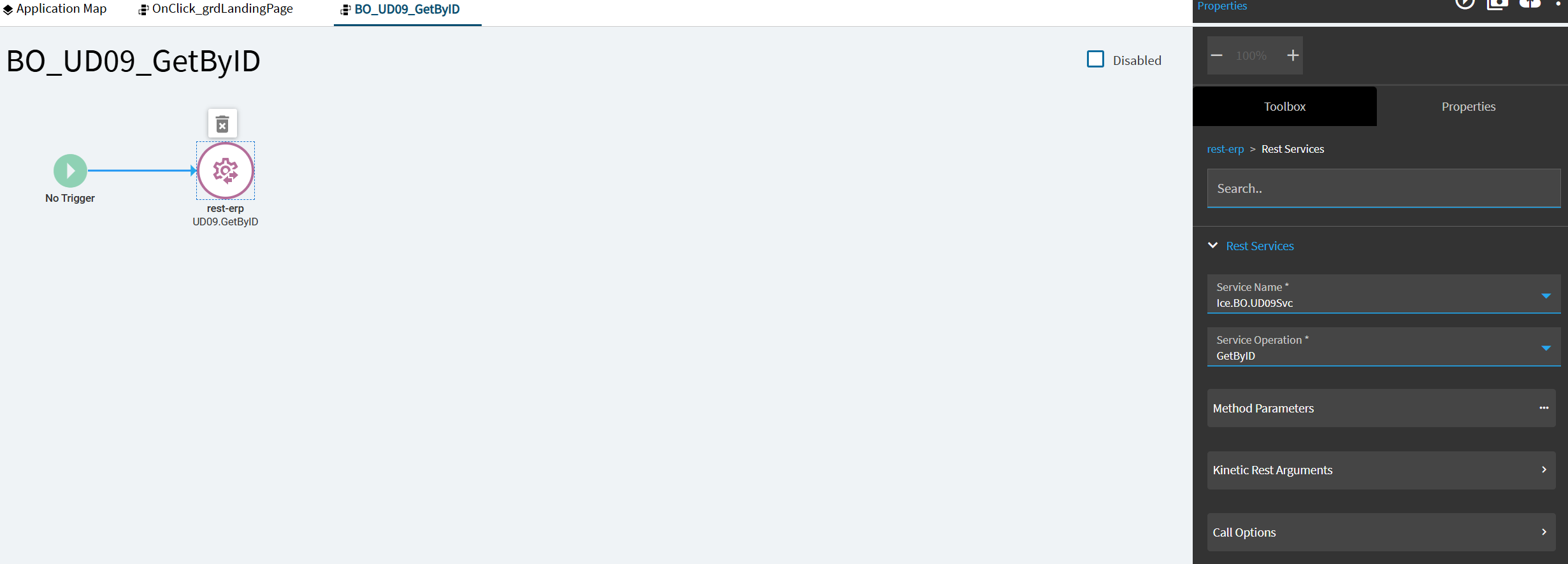

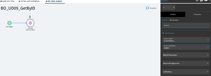

I don’t have access to edit the grdLandingPage screen, so I am calling the UD08_GetByID event after the TranID is picked on the landing page, and now I am getting parameter key1 input object not found, which I change the field below key1 under Method Parameters to LandingPage.TranID and get Record not found. Any suggestions? It seems like maybe the event is running and not picking up the TranID I chose so it has nothing to tell the keys?
