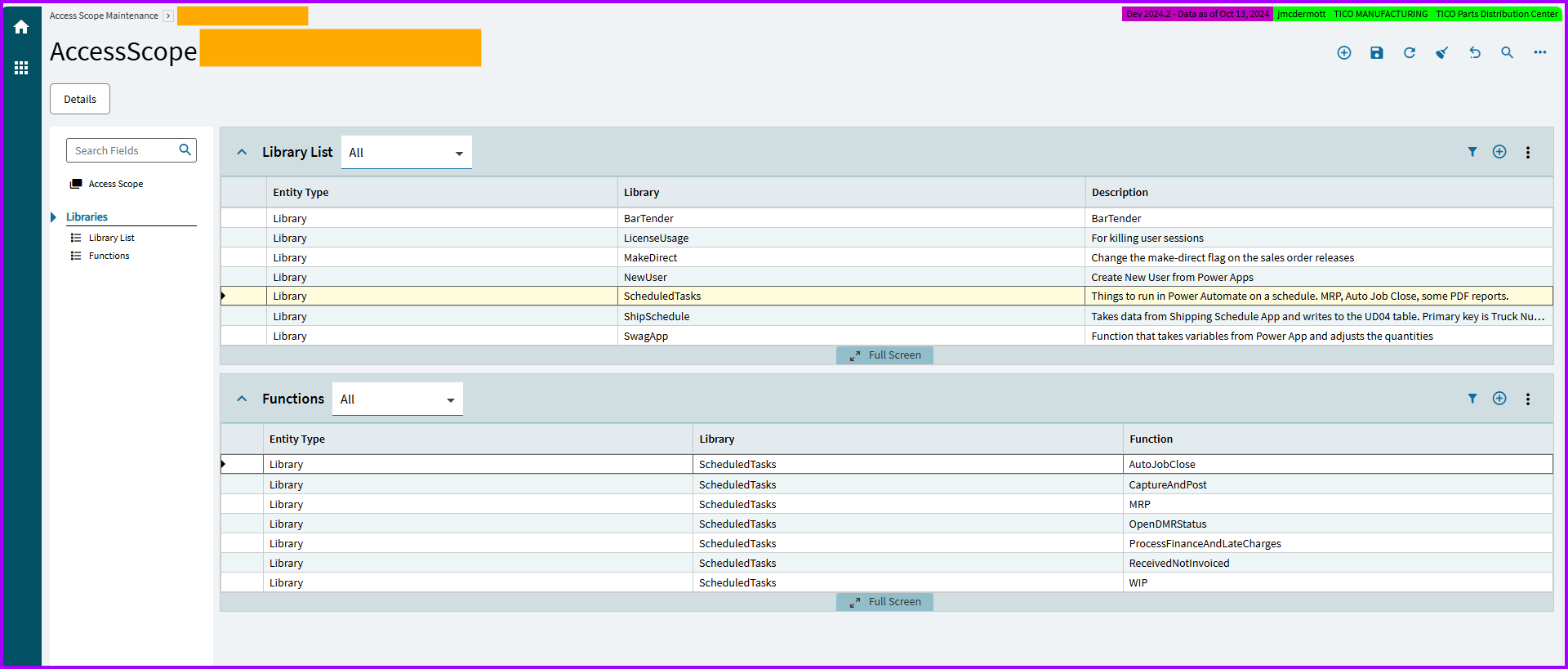

So I knew all of that, but you made me take a second look and, well, you are right.
So, as a rule, I (personally) never specify the Functions in Access Scope; I just add the library and leave the function area blank, which implicitly allows all functions (inheritance style). Whereas if you specify any Functions, it serves to exclude all others in the library.
And I assumed that was the case here. Nope. I think this was one a former coworker did, and she itemized the Functions. So when I created a new Function, it was not here in the list, thus denying the access.

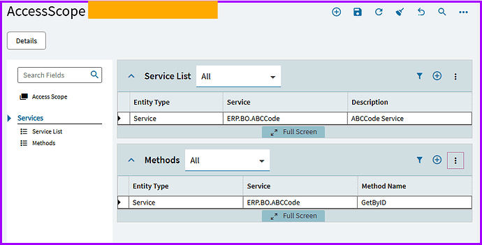

You know the flip side of all of that is that you really need to assign at least one BO (“service”), BAQ, and Function Library to all Access Scopes.
Meaning, if you specify a BAQ but leave the services empty - like I always do - you essentially have closed the front door but left the garage door wide open.
Guess I’ll give free access to ABCCode.GetByID!
