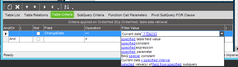

You need to change the BAQ's select criteria. We use this below in one of
our BAQs. Then we scheduled the BAQ Export to run on a schedule.
[image: pasted1]

Sure,

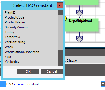

In this example, it's ChangeDate (first date field on the list), just set the Filter Value to "Current Date + Specified Interval" option. Then select Days/Weeks/Months/Years and go forward and backward (negative numbers) by those intervals. In the example it's -1 Day.
You could also use "BAQ special Constant". We sometimes have to run our BAQ for more than "yesterday" so we use the first option but this could work for your needs as well.

## Post #6 by @Randy
No, I was just showing both options for you. We use the first one I
mentioned, with the -1 Day, not the BAQ Constant for troubleshooting
reasons. Our users don't have to run this BAQ at all.
If for some reason --system maintenance, data connection issues, etc-- the
scheduled BAQ Export doesn't work, we'll need to go back more than one day.
So we manually change the criteria and run the query. But that's rare and
only when needed, so we do it here in IT.
