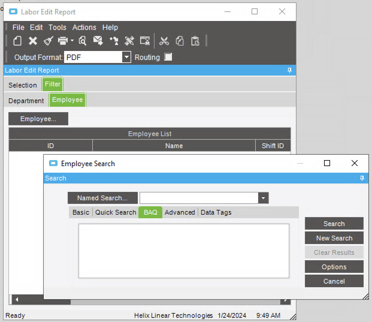

But also, when one launches the Labor Edit report from the Epicor menu, the filter criteria is by Employee and Supervisor is not an option.
That said, I realize now that I can use a BAQ Search as the filter criteria. That will met me schedule three reports each with its own BAQ Search criteria and then we only need to update the BAQs.

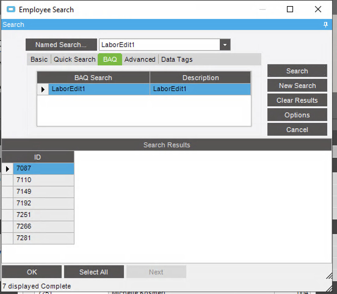

Actually, the BAQ search doesn’t work the way that I expected. It executes but presents a list of results and I still have to manually click Select All. That works for the initial scheduled report, but then subsequent updates to the BAQ won’t update what was previously selected for the report by using Select All.
So now I’m back to where I started. Any suggestions?
