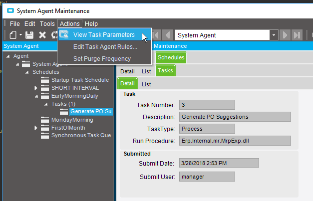

Each task shows up under the schedule in the system agent maintenance, and you can view the task parameters. We don’t use e-mail for ours so I’m not sure about that part, but I think it’s where that lives.
@Banderson is correct, you can view how you scheduled it there. What I am thinking though is that there is a saved default with a blank email for that report print form.
