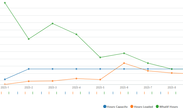

I’ve been reviewing the system zShopCapAndLoad BAQ.
Curiously, I noticed the ‘What If’ hours for Jan 1st until now are thousands of hours higher than the capacity and actual hours.
This is the data displayed visually:
This remains the same even after I run Global Scheduling. I also tried enabling ‘Global Reschedule Started Operations’.

Try running global scheduling with What If Checked.
The what if typically is use for a seeing what if you scheduled a single job early
What if isn’t updated and unless you check the box…
Thanks for the suggestion. Unfortunately, this doesn’t seem to have made a difference.
I confirmed via BAQ that none of our jobs are locked. I also ran the process with ‘Finite Load’ ticked.
