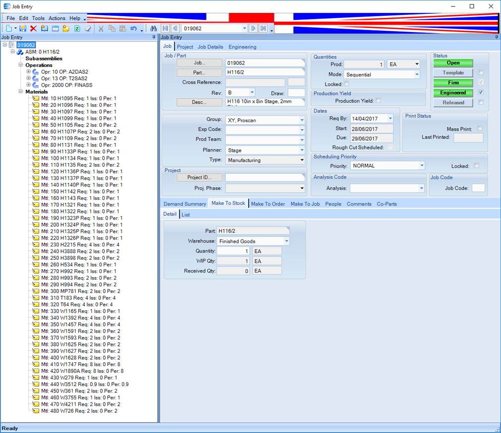

I have just raised the above job and scheduled it.
We have all parts in stock.
Required by date set to 14/04 (should be able to build it within a week).
Scheduled forward starting today.
Not Override Material Constraints (shouldn’t need to since we have everything).
Not Finite Capacity (we’ll fit it on a bench somewhere).
Scheduler sets start date to 28 June to be completed 29 June. Why?
Build time = 6.5 hrs
Test time = 1.25 hrs
Final Assembly time = 0.5 hrs
We tried going through deleting one component at a time and rescheduling to see where the problem lay.
It seems that W1457 (with a 74 day lead time) is holding us up. After deleting this part from BoM we can start the job 17 April - still not tomorrow as I would have hoped.
I still do not understand why this is since we have stock.

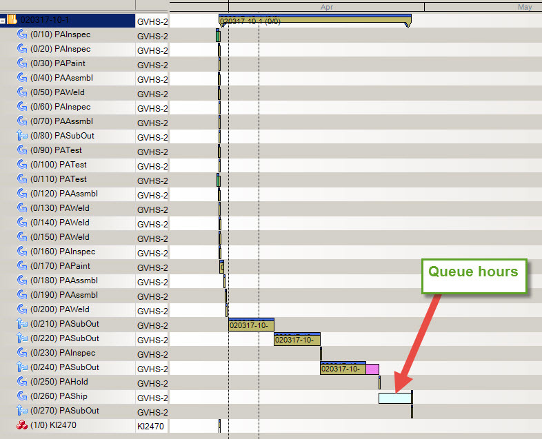

Does looking at the job via the job scheduling board provide any clues? See screenshot for looks of queue hours.
Do you have a receive time built into the main part going into stock. I have seen this before and it is usually due to the receive time or as the Other Nancy stated it might be the queue. Also, you stated that a specific part has a 74 day lead time, Try and change that lead time to maybe 72 or 70 and then reschedule the job to see if that helps.
