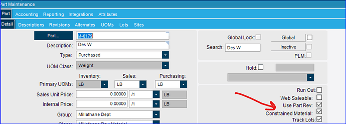

For the raw material is constrained material unchecked?
Where do I look for this?

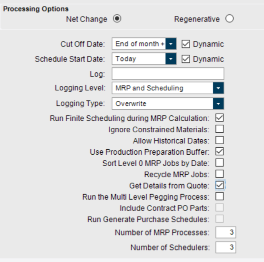

Looks like you’re on 10 or greater can you enable the logging feature of MRP/Scheduling and only process that part? Then you can see in the log exactly why it won’t schedule it
NOT SURE IF YOU GOT MY LAST MESSAGE BUT NO THIS IS NOT CHECKED

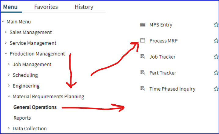

Agree with jgiese.wci. See if you can run Process MRP with logging turned on and look at the file.
I am not sure how to do that. I was just asked if I could figure this out
