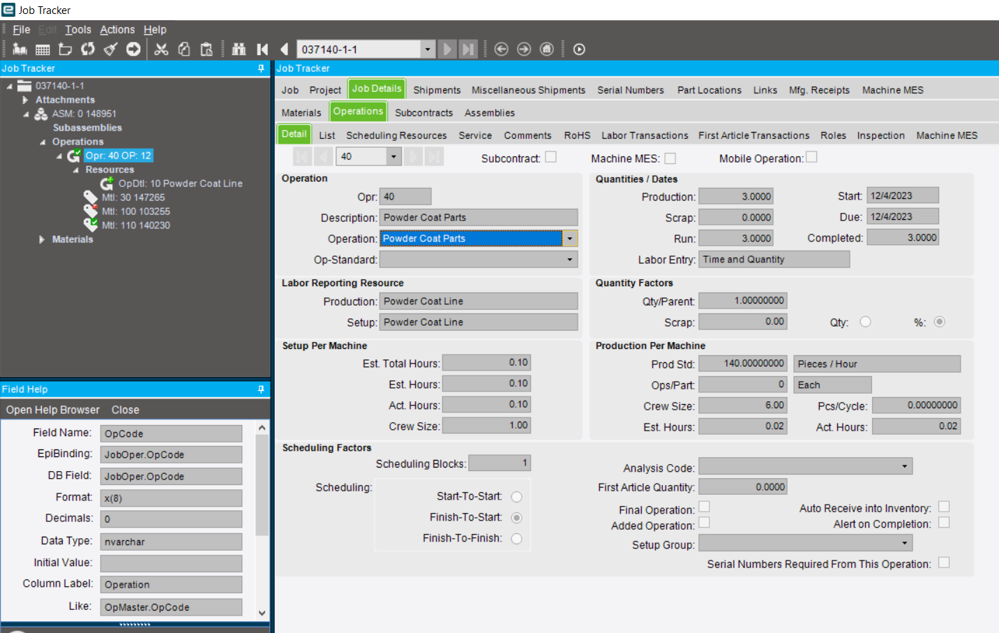

We will take an example of Job 037140-1-1.

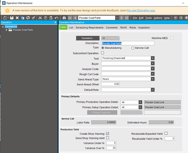

The job has 1 operation. The OpCode is Powder Coat Parts and it is OPCode = 12.

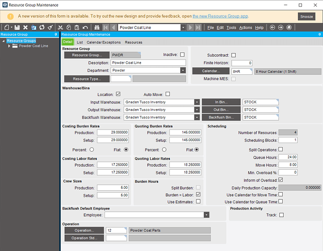

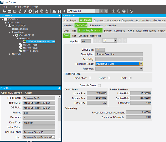

When I go to the Scheduling Resources tab, I see that it has Resource GroupID = Powder Coat Line. The Production Burden rate is $29.
This is OpCode = 12.

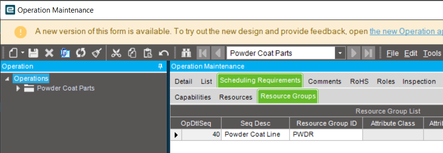

On the Scheduling Requirements tab, it shows the Resource Group ID = PWDR.
The Resource Group ID = PWDR is this screen. Notice that the burden rate is $145.00.
Why is job 037140-1-1 showing a burden rate of $29.00 and not $145.00?
