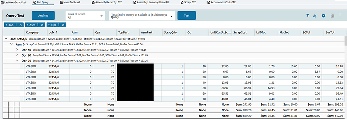

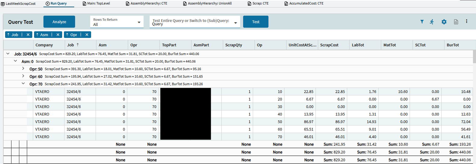

Scrap Cost CTE
I have a BAQ that attempts to estimate the cost that went into scrapped parts. It should recursively search the parent and children assemblies, and materials for subassemblies that have been worked on prior to the scrap being generated. Despite the best efforts of folks here, I still don’t understand CTEs. I am pretty sure it is necessary for this kind of recursive search.
So for better or worse, I have been using GPT to write SQL. It does a terrible job, and can’t follow Epicor’s rules about aliases. But it seems to know how to structure a CTE better than I do. Once I correct the errors, I got this BAQ:
LastWeekScrapCost.baq (18.6 KB)

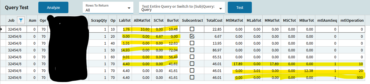

LastWeekScrapCost - Looks back at the labor from last week, and only considers parts that were scrapped. For these parts, it should pull the assembly, and operations, along with costs from JobOper. It will roll those up and give a unit cost, and a total scrap cost (unit cost * scrapped parts). It keeps the labor, materials, burden, and subcontract costs separated while we verify this makes sense.

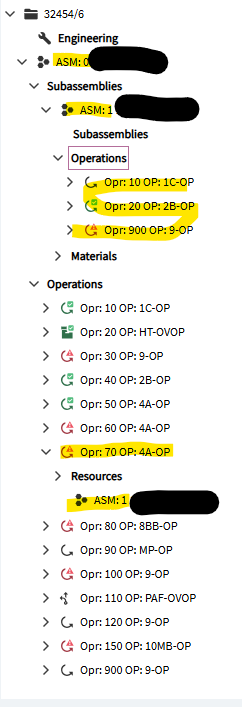

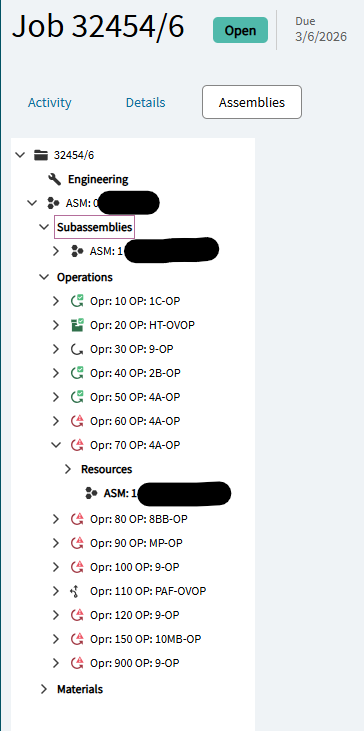

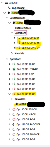

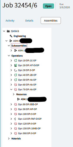

I have an example job I am trying to make sure I get all the costs from. In this case, Asm 0, Op 70 has a material needed. That material is Asm 1. So if a part is scrapped at op 70, then the work done on Asm 1 needs to be included in the costs. If the part is scrapped before op 70, then that extra assembly hasn’t been worked on yet, or at least it hasn’t been consumed by the job, so no cost is associated.
This is the part I can’t get to work. The BAQ pulls in subassemblies, but not if the subassembly is a material on an operation.
Clearly I still don’t understand CTEs. I have not been able to build one by myself, but I can edit the ones already made. Can you tell what I am missing here? I feel like it is a small step to the finish line.
Thank you for your time!

I couldn’t make sense of the BAQs you posted. Here is the SQL for mine:

The thinking is that we run this once a week to understand the costs that went into parts that were scrapped.
Conceptually this BAQ starts at AssemblyHierarchy CTE. This CTE pulls JobHead, JobAsmbl, and LaborDtl. It only looks at labor entries for last week, that had scrap. From that we pull the top part number, and assembly part number.
The next step is the AssemblyHierarchy UnionAll. Using JobAsmbl, and the previously created CTE. I think this is part of the recursive nature of the CTE. I don’t fully understand it.
The next step is the Scrap CTE, which looks at LaborDtl, and pull scrap quantity. by job/asm/op. Scrap CTE and AssemblyHierarchy CTE both use the same set of subquery criteria to get scrap labor entries from last week.
Next is the AccumulatedCostCTE. This is where all the costs get identified and gathered up. We start with the scrap table, join in the hierarchy, and then join in the job op and mtl tables to get those costs.
Finally, at the top level we pull all the data together, and calculate some totals.

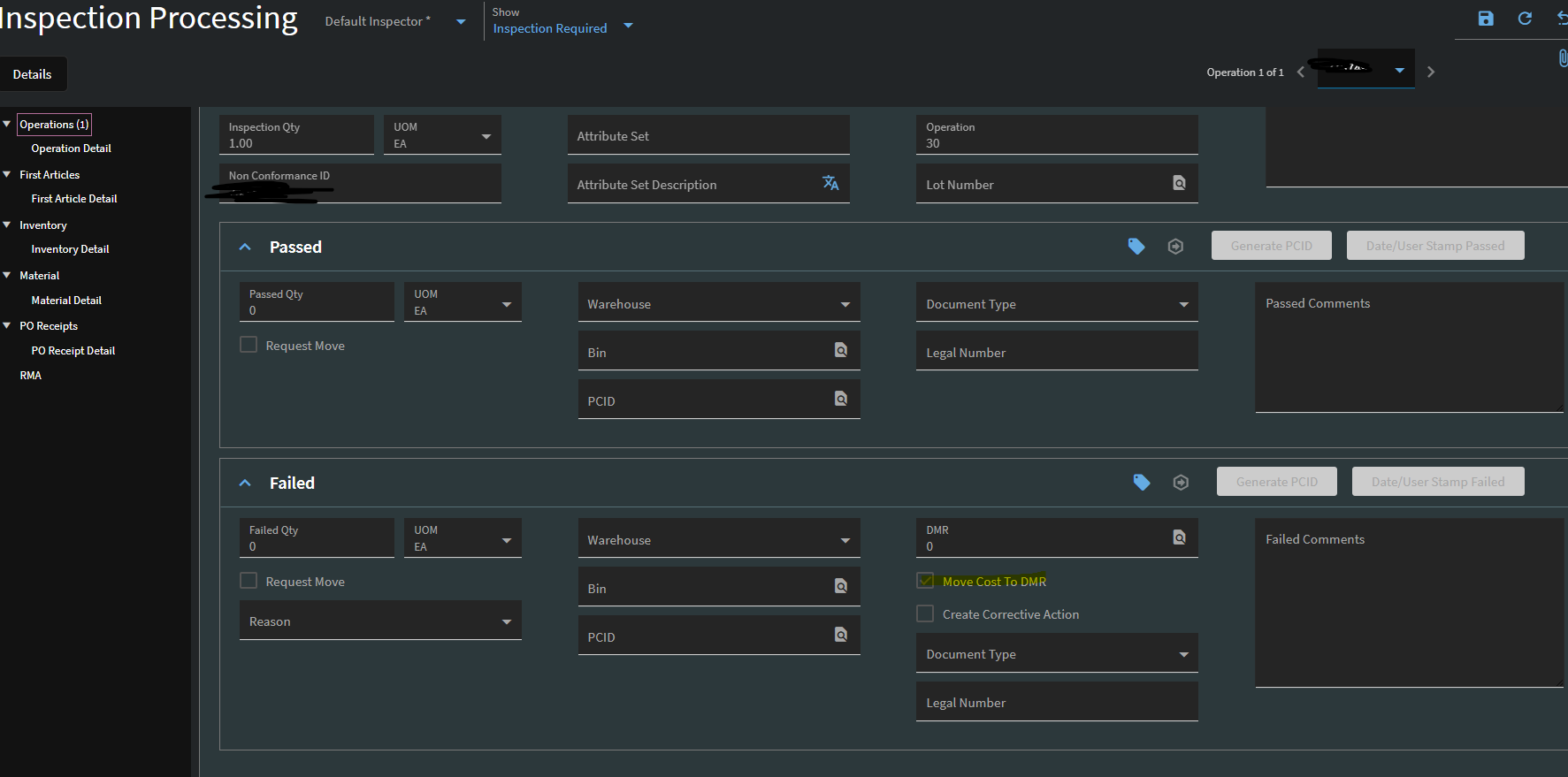

Also, are you not pulling scrap costs from jobs to DMR when a NCM is processed? This will pull the exact cost(for NCM qty) at that point from the job and put it on the DMR.
If your management/accounting teams like the idea…
When a scrap qty is claimed on an operation and goes to inspection processing, you can check this box. This will move the cost to the DMR and you could report costs from the DMR directly.
I’m not sure what those are! We don’t have the quality module. I have not seen those TLA and LLA fields before, what table are those in?

Here is an example. At op 70, ASM 1 is used. So if scrap happens at op 70, it should add up the costs for AMS 0 ops 10-70, and ASM 1 ops 10,20,900. Adding up the top level is easy, but once I try to add in the assembly it blows up this CTE BAQ. I think this is why I need recursion.
This shows the current results of the BAQ for that job:
You can see the costs up through op 70, and then at the far right, you can see the ASM costs. I am so close I just need to add up the highlighted fields.
(Just noticed MtlMat,MMat cost in there twice. Ignore that mistake.)
I think I got it! I would appreciate if anyone provides feedback on this. Until then, I will be using it to estimate cost of scrapped parts.
