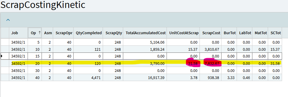

Here is a snip of my BAQ showing the relevant data for the part in question. Here you can see that the 248 pieces of scrap happend at op 40, and you can see the costs that went into these parts for each operation up through #40. I think I need to change my SCTot calculation to look at the required qty, instead of the completed qty. But I have to do that break out at op 20. Im so confused!

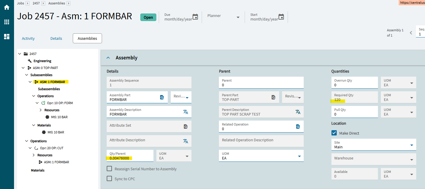

Sorry we do use scrap, so I may be off-base but I wonder if your cut piece should be an assembly consuming the 120ea bars @ 0.00476 (1/210) quantity per parent. At least then mtl cost reporting 248/4471 scrap may be proportional.
For example, this Job ProdQty: 25,200 having FORMBAR SubAsm @ 0.00478 per parent shows RequiredQty = 120ea. BAR raw mtl is 1 per parent Asm FORMBAR. This Asm is what you get back from your SubCon.
CUT Opr20 consumes FORMBAR and now reporting qty and scrap is proportional?

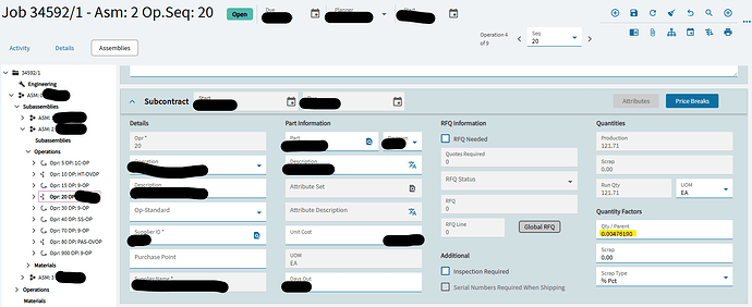

Our setup is not that different from what you posted, the op has a qty/parent of 0.004.
The next op 40, has qty/parent of 1. You think if we switch op20 to an assembly it might record the costs correctly? Isn’t consuming the material on op40, the same as consuming it in an assembly? I admit, I’m not an engineer and don’t know this as well as I should.

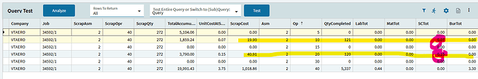

multiply by jo.QtyPer everywhere you have jo.QtyCompleted and see what happens. :man_shrugging:
BAM!
bam yes GIF
This did the trick! Thank you!!!
For anyone wanting to see what their scrap cost looks like, try this out!
