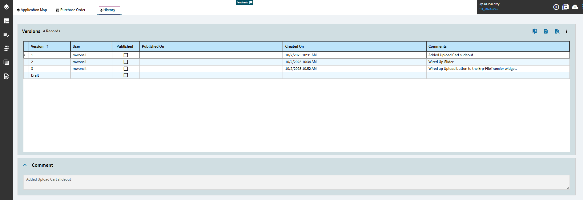

No report, but at least in 2024.1, there is a history tab on the left which will show you all of the Commits, who made them, and when.

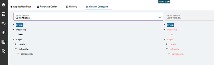

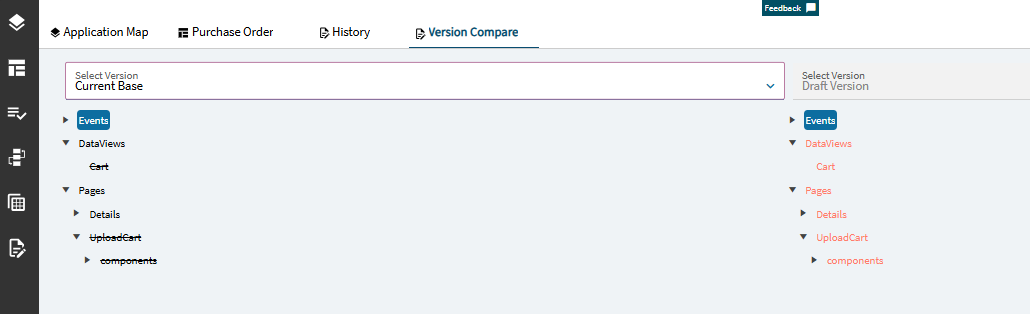

You can compare the most recent version to the base:
You need to store versions in the database and not file system, and I don’t remember where to set that… ![]()
