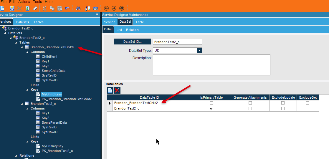

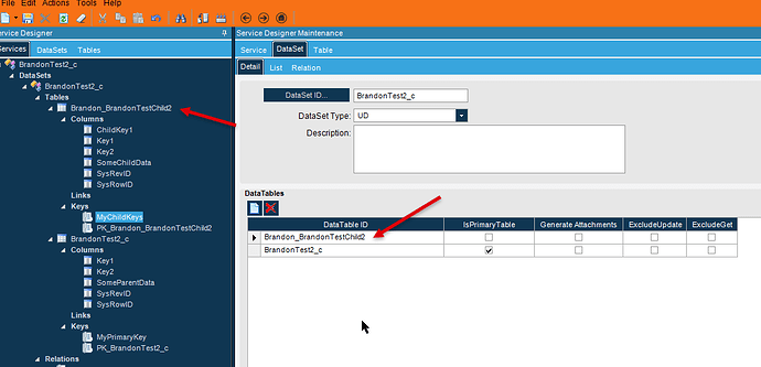

We figured it out. There is a “requirement” of a table needing a prefix. Which it only needs if you are adding just a table. When you do the service, it doesn’t require that. Because of that bumper, I wasn’t understanding why I couldn’t add a table. Once we figured that out, I was able to add the child to the dataset and service, and set my relations correctly.
Once that was set up, I generated the service, recycled, and now I have a service to finally get new me’s (much to Jose’s relief :wink: )

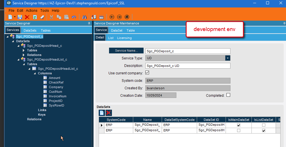

Ok, now I have that setup, I re-made one and it seems like it’s working. I’m working on trying to figure out how to move it from one environment to another. I’m trying to use solution workbench, but I’m getting an error with the list dataset and I’m not sure why.
So in solution workbench I have ZBODef, ZDataSet, and ZDataTable.
If I do all of these and try to import them I get this error.

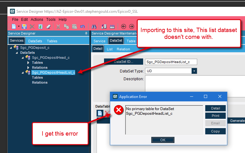

The cancelled record if the List data set. But I can’t figure out why it’s doing that. The list dataset that was created was the one that Epicor created when I used the wizard to create the service to begin with.
Does anyone have an idea what I could be doing wrong? Is there another way to package this up? Does the order matter? For example, do I need to import something, then regen, then import the rest?
I’ve been looking but I can’t find anything on transferring components for the SDK.
I don’t have anything handy but that sounds like a bug that was fixed where the list table was being treated as a DB table not a temp table. I do some digging the DB. I’ll also see about getting a parent child examples documented
it isn’t a public facing bug report, it was internal but I do show this as apparently fixed in 2024.1 what version are you working with?
23.1 I’ll try it in 24.1 and see if it works on Monday. Should I be able to import all 3 Z objects at the same time? Or does it need to be done in steps?
For 23.1 it needed steps I I think a manual DB edit - it was an ugly issue. Should be much smoother in 2024.1

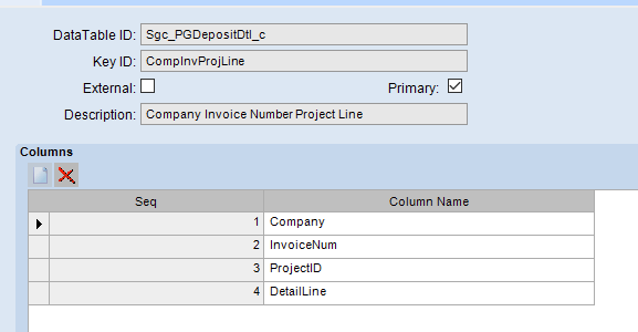

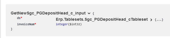

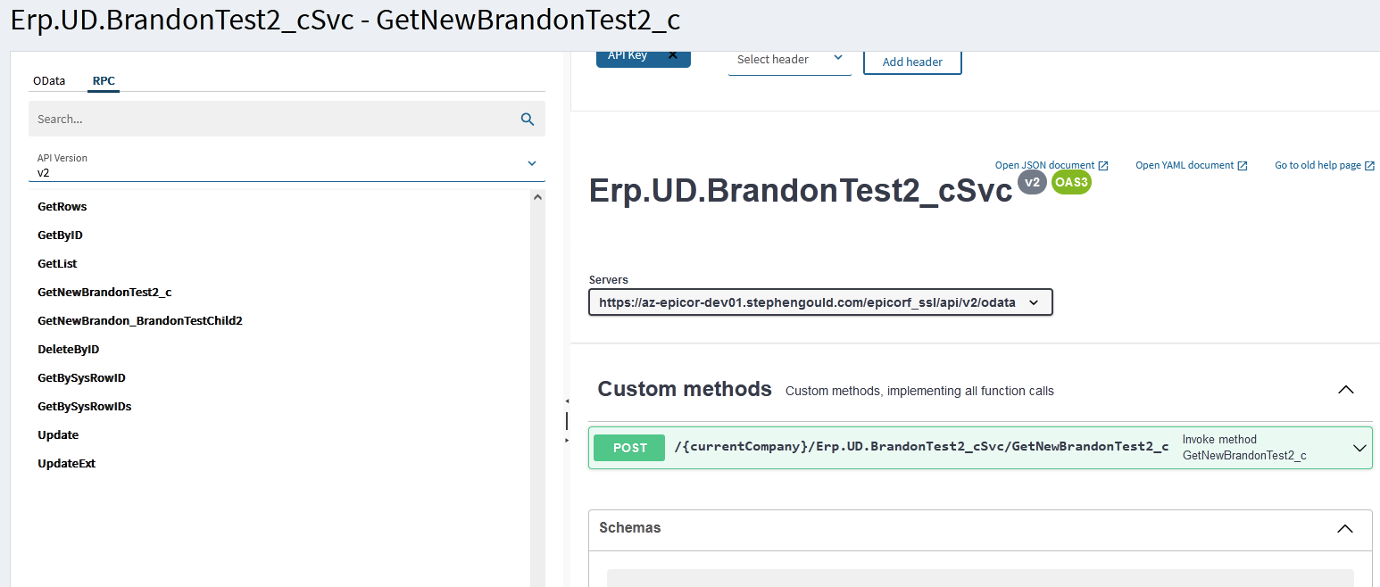

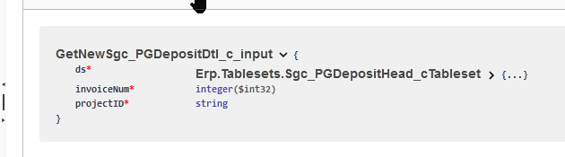

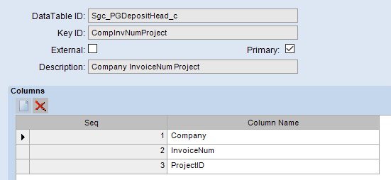

Next question I have is, how are the input parameters determined? I thought it was related to the primary keys that you set up, but that doesn’t seem to be the case. I don’t know why it picked up InvoiceNum but nothing else here. I guess it’s not a huge deal, as I can just set the fields outside of the get new call, but what’s the point of having anything?
On the child table it’s a similar thing, it picked up 2 of them, but not the other two.
