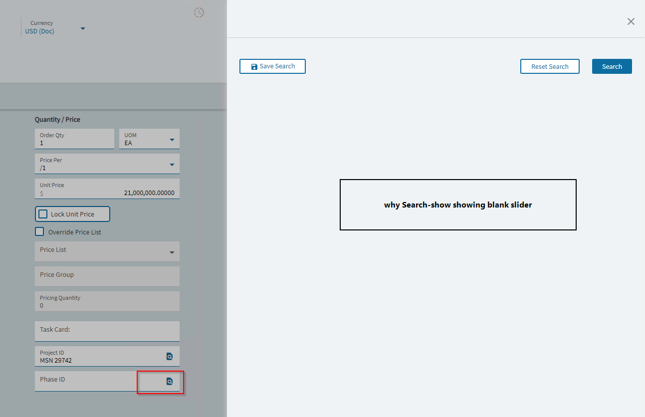

Search-Show Displaying Blank Slider in Application Studio

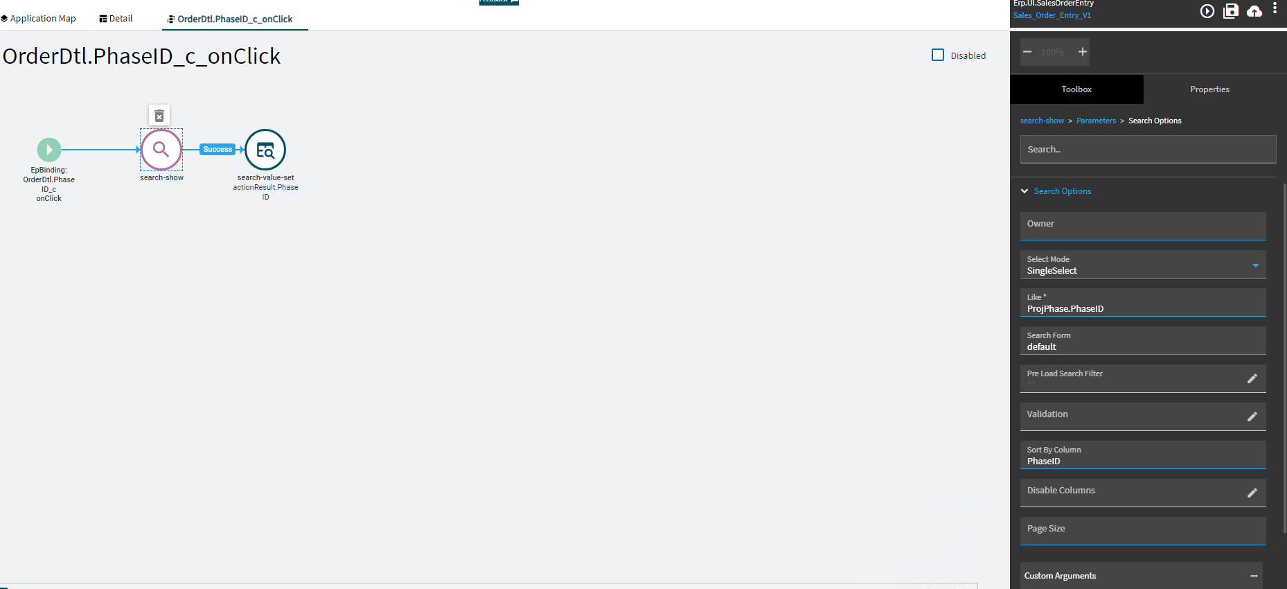

Facing an issue in Application Studio with a searchable text box.
Configuration details:
  • Control: txtPhaseID
  • ERP Binding: OrderDtl.PhaseID_c
Advanced Settings:
  • Search Enabled
Behavior → On Search Click
Trigger:
  • Type: ErpBinding
  • Hook: On Click
  • Target: OrderDtl.PhaseID_c
Search-Show Configuration:
  • Select Mode: SingleSelect
  • Like: OrderDtl.PhaseID_c
  • Search Form: Default
  • Sort By Column: PhaseID
  • Preload Search Form:
    ProjPhase.ProjectID = '{OrderDtl.ProjectID}'
  • Use Get Rows: True
  • Search Type: Basic
Search-Value-Set Configuration:
  • Value:
    actionResult.PhaseID
I believe it’s going to have to do with your search-show Like property. There’s a built-in list of searches that are linked to different fields (e.g. Part.PartNum), none of which are going to be a UD field.
You might have to do something dumb like put OrderDtl.OrderLine instead. You shouldn’t have to change anything else, but might want to use a BAQ search to get the phase ID column in the search results.
