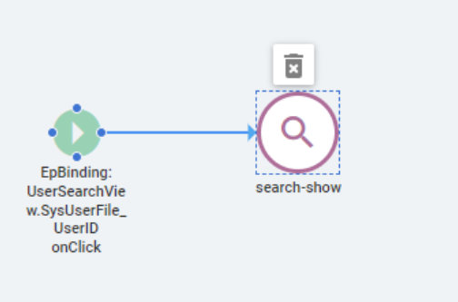

Hi, im creating a new app in application studio. I have a text box which is searchable. The search-show component calls a BAQ. I previewed the app, the slider that opens up when the search icon is clicked is blank. My BAQ uses only one table (Ice.SysUserFile) with 3 fields. I tried testing with a system BAQ and i can get result. Im not sure where im doing it wrong. Been stuck with this for days. Some help would be good.
On search click settings:
search-show settings:
All other fields not shown here are left as default.

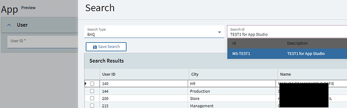

When i preview the app, i see this:
You can see that the slider is blank. Any advise pls? Thanks

genoah.martinelli:
UserFile.UserID
Hi, I changed it to UserFile.UserID and it magically works!
I tried SysUserFile before as that was what was stated in the BAQ.
Why does âUserFileâ works? How do i find out this from the system?
Thanks so much for your assistance.
Kinetic has a (very well hidden) list of searches that youâre able to use. The easiest way to find out what you need is to reference a stock screen in application studio. If you type âsearchâ in the event panel, eventually youâll find the event with the search-show widget and copy what they have.
The âactualâ list is a lookup into Ice.XXXDef for the files Kinetic needs to show you the search panel UI (itâs just another app ).
The reason UserFile works but SysUserFile does not is because Epicor probably didnât see a need to create a search for SysUserFile. The tables are nearly identical anyways, so itâd be a little redundant to have two search UIs that do the same thing.
