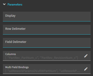

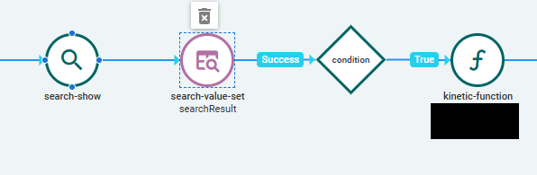

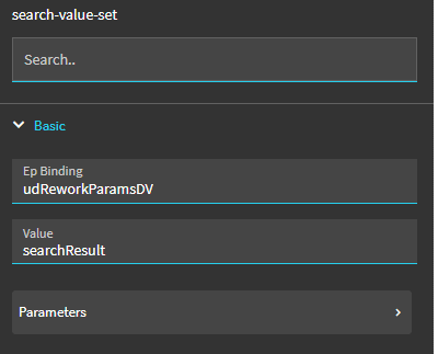

I have a search-show and search-value-set on a button click event along with numerous other widgets before and after.

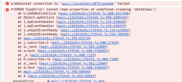

The Search-Show is set to UD22 with a filter and it works fine. I see records and even this morning when I first tested it (the OK button didn’t work yesterday) it worked where you click the OK button and the remaining widgets in the event fire and work fine. But then I added a widget (a condition) and it worked. But the thing that broke it was adding a widget to the condition if there was a false return. At that point, when the search came up, the OK button didn’t do anything and I got this error message in debugging
I then deleted the widget that I just added and re-ran to make sure it worked, and of course it doesn’t. I closed out of application studio and reentered, I closed the browser and reopened and still when I click the OK button, nothing happens.
Here’s the kicker. If I delete everything after the search-value-set, it works. This is really aggravating. I’ve probably spent 4-5 hours going back and forth deleting/recreating widgets to find that magic combination of it all working.
Go figure, I add a widget back to the false condition of the condition widget and now it suddenly works. Epicor really needs to make a better product. People can’t waste hours trying to find the right combo of how and when to place the widgets and charge the customer that time. I hope I don’t have to change anything to that event…
