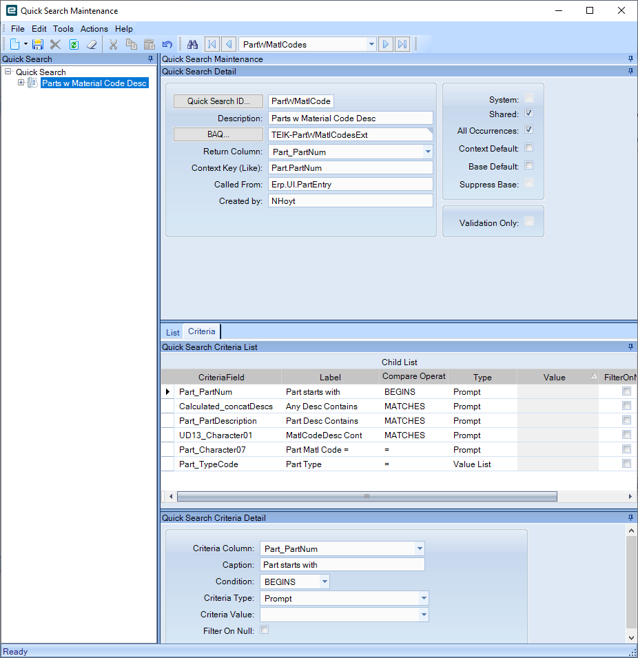

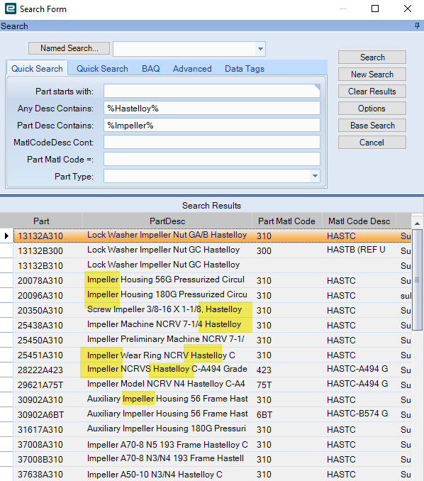

Hi Joseph,

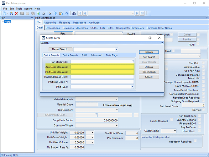

How about you put in the description field match multiple times, say for however many different words you want to allow to add to match? I noticed ours also does not allow out of order match but if I do it with two fields both getting matched, voila, it returns regardless or order of search terms.

Thank you, we did think about adding multiple search fields (we are in Kinetic), but what we really would is to have this ability in the GRID view. In Kinetic, it is very easy to add or search for parts from the various grids where the salespeople would add part to an order or quote. We may do do a BAQ as a workaround with a second, duplicate, type field - that would be a help.
Thanks for the screenshots and taking the time to answer, it is very appreciated.
