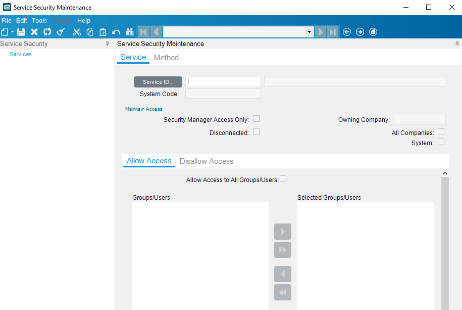

And this becomes even more important when people are not accessing resources through Menus at all. We need to think about access through DMT, Service Connect, and REST as well.
Yes, api level security!
Ive had issues with getting DMT to be secure using menu securities. I went back and forth with Epicor support trying to get it to work and they acknowledged the same issue.
This was when we were on 10.2.200. I havent tried since upgrading to 10.2.700.

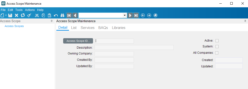

I think we need to start looking at Service Security and Access Scopes to properly lock capabilities down.
That’s what I did to lock down DMT. added a method security.
