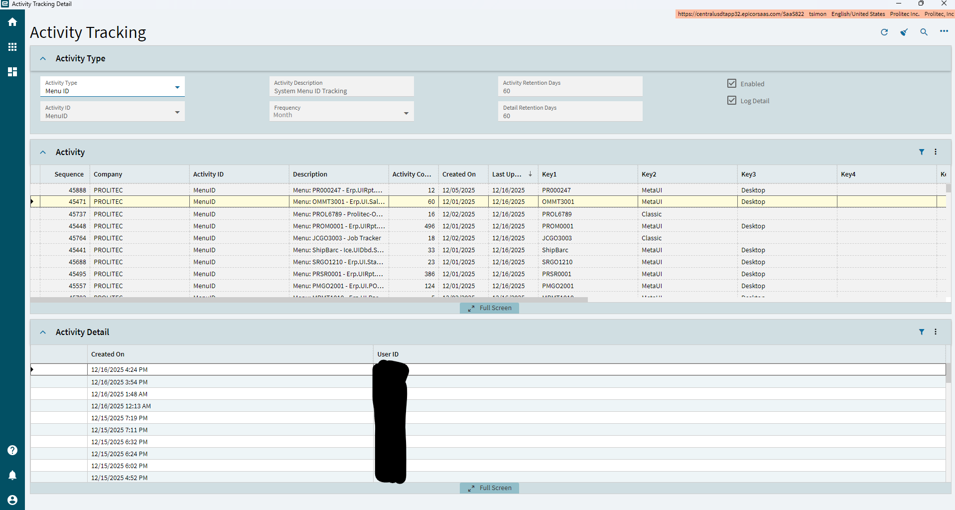

I’m coming into this project having never done a cleanup like this before. I’ve done some research and feel I have a handle on the basics of what we should be doing. However, I’m wondering if anyone who has gone through this process could share any best practices or potential roadblocks we may come across during this transition. In particular I’m interested in if Epicor has a way to audit what screens are being used and by who so we can ensure as few issues as possible with new access once we push this update.
Absolutely any help is much appreciated!
In Activity Tracking Detail, there is the Menu ID type. If you have the log detail enabled you can see who opening the screen. This is also very useful to see if the dashboards you spent a long time creating aren’t being used. This won’t be retroactive if you don’t have it currently enabled. It’s been very useful to determine which screens I can get rid of when we go full in the browser.
