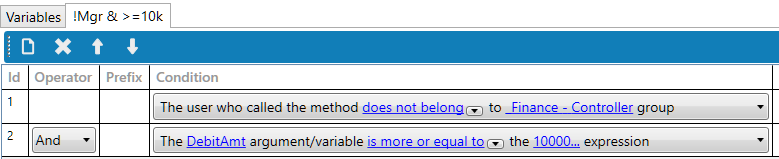

Thanks for the input John & Juan! I’ve spoken to the finance department, and we’ll restrict access to Actions > Post via a BPM. Seems to be the least complicated way to achieve the goal.
I think the BPM will be the best.
I looked at a couple posting rules, I have some ideas, but I am in the middle of a go live.
So I can’t give you a definitive answer.
Can’t you do this via Service Security? Might be easier than a BPM.
Doug,
Can service security have logic? We’ve always used it as all-or-nothing. That would be sweet if it does…
No, I thought you were wanting to simply lock down the Post action. If you’re doing logic in the BPM to sometimes let it pass, then that’s the way to go.
The request we got was to allow under $10k to pass, and over $10k to be restricted.

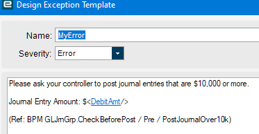

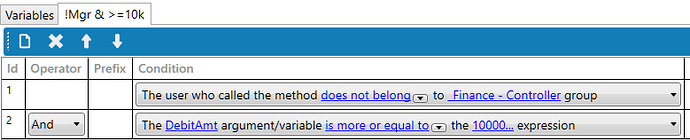

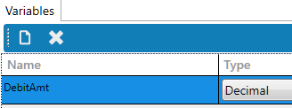

Here’s the simple BPM:
Db.GLJrnHed.Where( r =>r.Company == callContextClient.CurrentCompany && r.GroupID == groupID).Select( r =>r.TotDebit).FirstOrDefault()
