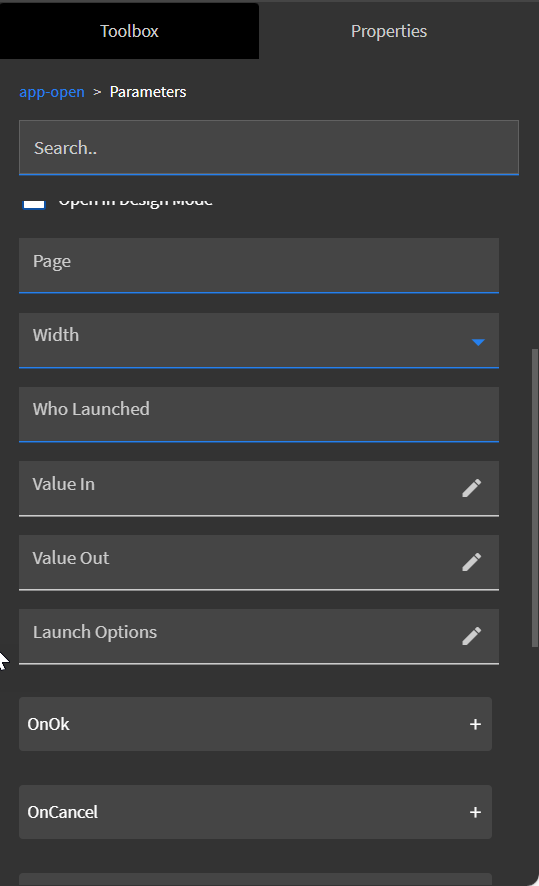

Have you tried setting the line and release via “Launch Options”?
I have set values when launching a report to set which row in the grid was the item we wanted to print with the code below. Maybe you can use it to set the Line and Release.

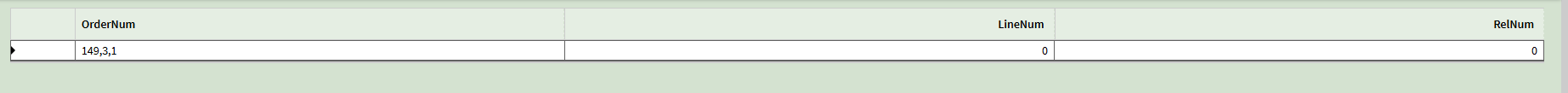

Yeah I have used that code before and the only valueIn it will put everything into the OrderNum example below
