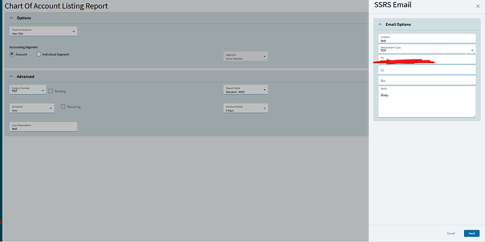

Anyone here have a deeper understanding of the API request that’s being formed to send to sendgrid API and why we might be getting this error back?
{“errors”:[{“message”:“The content value must be a string at least one character in length.”,“field”:“content.0.value”,“help”:“SendGrid v3 API reference | SendGrid Docs | Twilio”}]}
People are scheduling reports to run with the email action and some go, but some fail with that error. This is not APR, it’s just the base “email” action when submitting a report.
Any help or tips or breadcrumbs that lead to something are greatly appreciated!

@Mark_Wonsil or @spaceage or @kve using ice.MailLog, do I turn that on at the app server side and would that log the payload? Any downsides to turning this on? performance hits, etc?
Or?
I am trying to understand how the task is going from this (see screenshot below), to the payload that sendgrid is expecting:

Thanks everyone, I believe that because the “body” was left blank I think the content property is blank.

MailLog only logs the addresses, not Body. And you must be right, empty body should cause this, attachments are separate fields probably.
Thanks Olga, would be nice to log the API requests at some point if possible, I should send in an idea or something.
well, complete request could be huge, and we don’t use it directly, we use SendGrid’s Nuget that hides the request itself.
