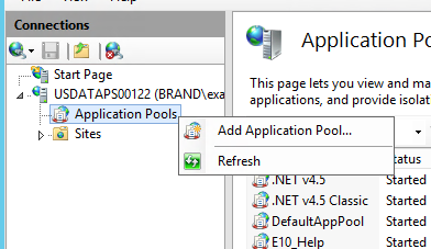

Regarding #2, I don’t see the where the Auto-Start is selected.
Right click on “Application Pools” yields:
