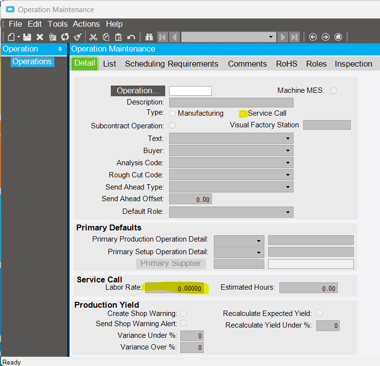

We were able to see the labor costs when we set the Service Call Labor Rate on the Operation.
