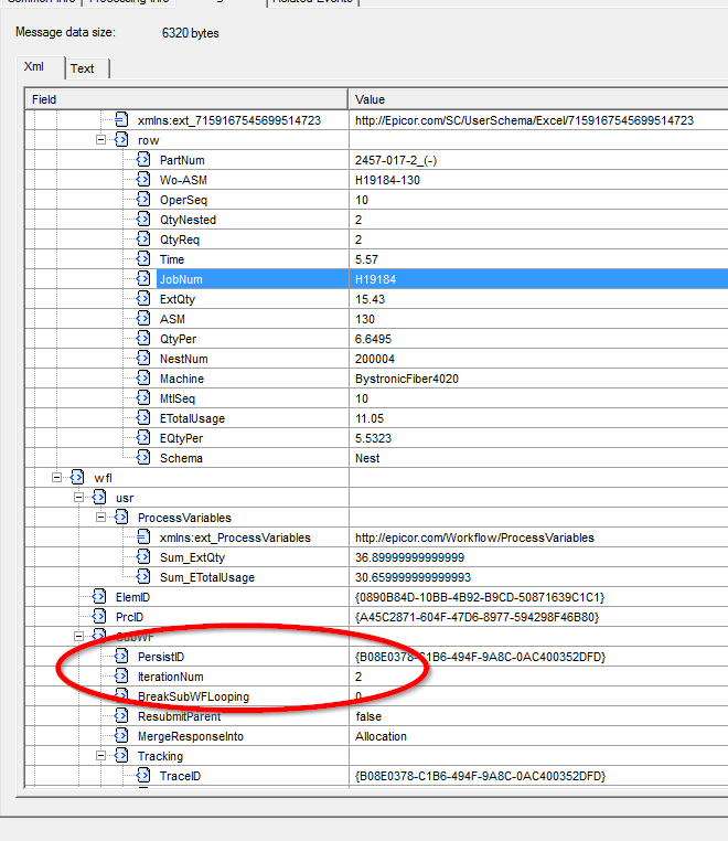

under the wfl node there is an IterationNum, tho i wouldn't recommend using it for what your'e after (what if the record didn't get created?). Do a get rows after the update and use a functoid to count the rows returned, and store that in the schema you will pass back up.

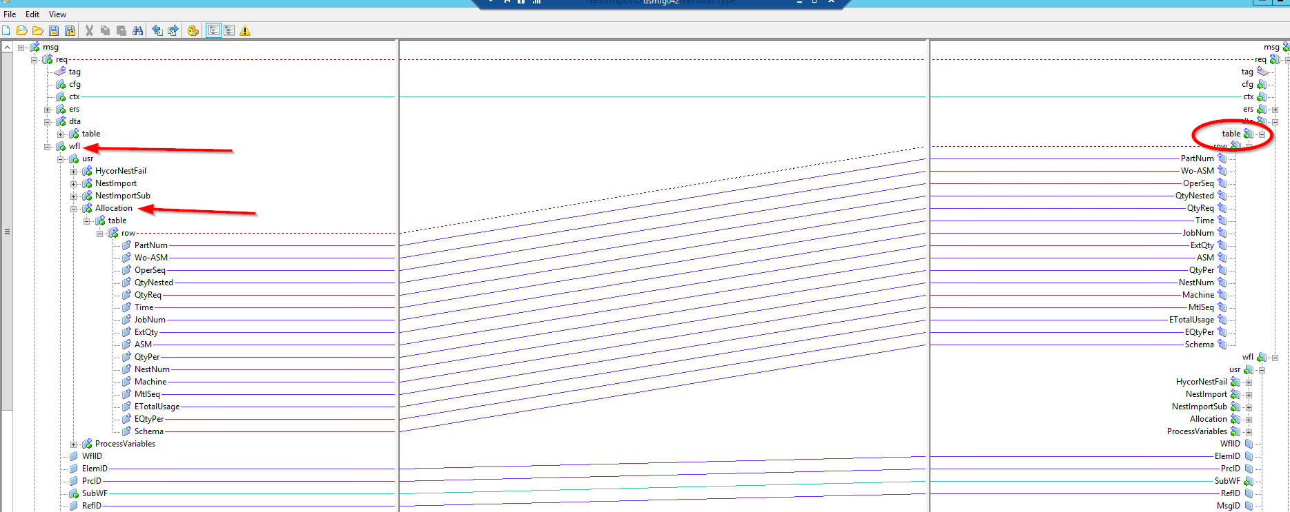

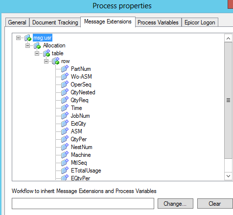

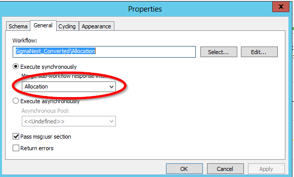

Your collection schema (defined in your sub element) needs to be a table, it can't have a sheet in it (a bug?). In your sub workflow create a msg extension with the same name of the collection in your calling work flow
the finish element of the sub should have the schema you want for passing the data (map your stuff to that)
below is the xslt transformation in the parent immediately after the sub, you should be able to see your nodes under the collection (in this example, Allocation).

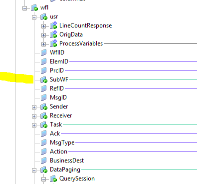

I did see the IterationNum, but I didn't know how to extract that value (in a functoid) & store in a field - is there one that would let me put in that value? *it doesn't show up in the transformation, it only shows up after the run, in the data log, like you show above. But I wondered if there was a way to reference that 'by name' somehow, in a functoid?

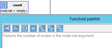

Once we work out all the data issues, the format of the data should be pretty much the same in all files. They will not even edit this data generally, will just write the paychecks of what the file fed in. I looked at that count node-set but didn't think it would work, wasn't sure but it didn't seem to return the iteration #.
I'll give that a shot, the steps you laid out to get it to return a table & see if i can get that working. I didn't quite get that nuance of naming the msg extension the same name as the calling wf collection!

## Post #4 by @rbucek
if you see data in the log, it's available for you to map and work with.

Yes you'd think so, but it's not visible in the conversions, so if I can call it by name somehow that may work but not sure how/where to do.
This SubWF doesn't expand like you see in the log, when in the conversion mapper (inside the swf):
You just see this:
So I can't drag IterationNum to any field or functoid.
