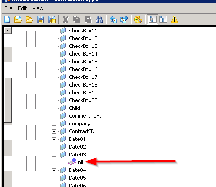

i believe it's done through the nil sub node (the attribute must be set within the xsd first). Right click on the sub node and set xsi:nil, make sure the check box is checked and you'll see the node change it's status.
the node in your schema should look something like this...
xs:element minOccurs="0" name="Date03" nillable="true" type="xs:dateTime" /
and in your xslt

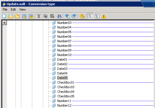

Thanks Rob. Is there a setting to enable the sub node? This is what I see.
## Post #4 by @rbucek
right, that's the trick... most of those schemas dont come in like that. I havent taken the time to delve into why some have it and some dont. If you edit the schema directly you could put that attribute in the node and see if that works. I've had some luck customizing schemas in the past. I havent tried to force that one in yet tho.
