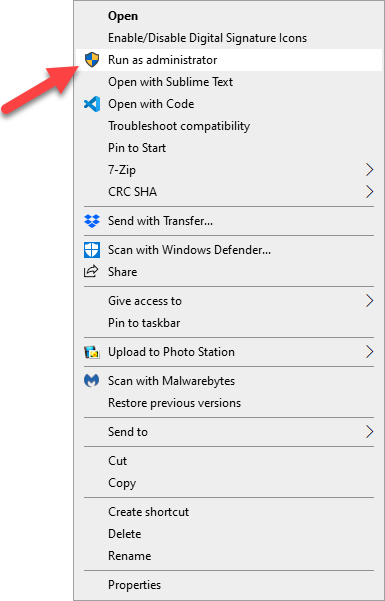

Did install running the setup using Run As Administrator?

Does the account that you are logged in as, have local administration privileges?
Just to clarify when I mean Run As Administrator I mean like by right clicking on the setup.exe and clicking
