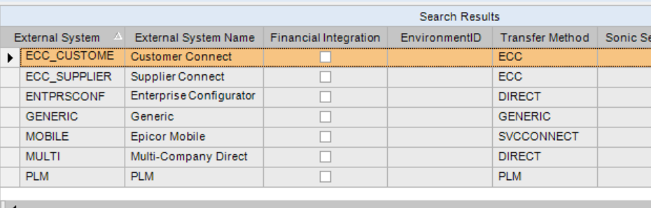

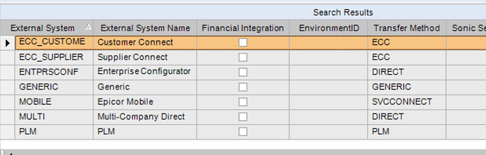

It is weird. There were some references to “ServiceBus” in the External System Maintenance area (no idea how they go there). I deleted them but still get the same error when saving BAQs.
