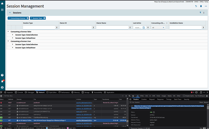

You need to open SessionLogger.py with a text editor and fill out the needed variables as seen in this image.
You will also need to set up an API Key in Epicor.
How does it work?
It just calls the same service that populates the Session Management Menu.

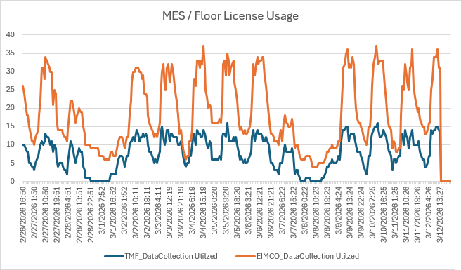

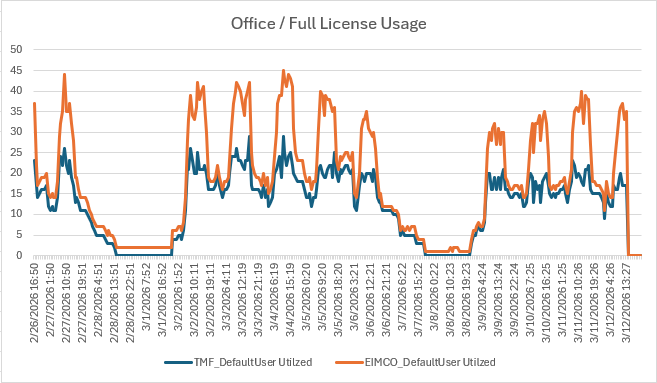

The end result is a spreadsheet which can be used to create graphics like this one.
