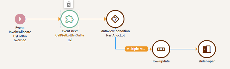

I am trying to help us get by until we are ready to turn on automated fulfillment. We would like to simplify the process and remove some clicks from the process. When you go to allocate lots/PCIDs, we want to automatically fill in the PartAllocLot.NewAllocatedQty with the PartAllocLot.AvailableQty. When I do a row update, it only fills in the first row. When I do a dataview-condition tied to multiple rows, I do an update, but it still only updates the first row.

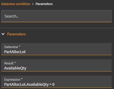

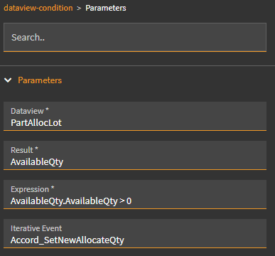

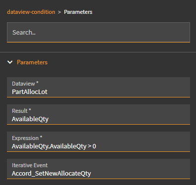

Can you share your dataview-condition set up?

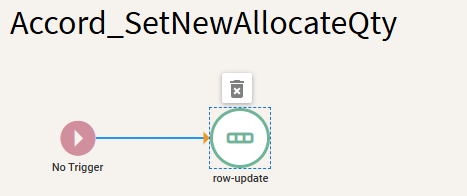

The way the dataview-condition is set up there will only do one iteration,
if you want to iterate, you need to set up a separate event, and put it in the dataview-condition as an iterative event.

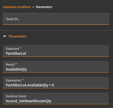

Like this or should I be changing the trigger?
Nope, that should work. You dataview-condition is acting as the trigger. It will then do that row update for each row that matches the expression in your dataview-condition.

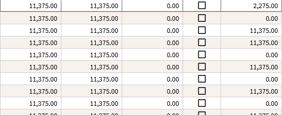

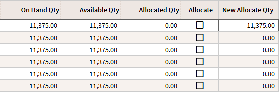

It runs gives me a generic error and then opens the screen and provides me with the same results. The first row is the only row that updates.

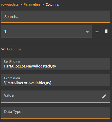

What is your row-update? Are you updating AvailableQty.NewAllocatedQty?
Gonna feel stupid when the row update has been off this whole time :man_facepalming:

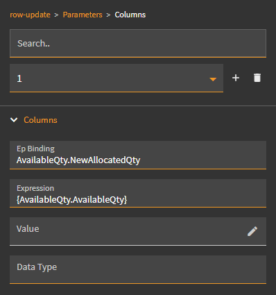

change the Ep Binding to this: AvailableQty.NewAllocatedQty
Now i have to figure out why some of these are getting an error.
Edit:
Even weirder…

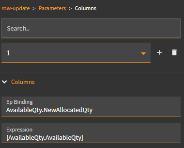

For each row, is the goal to copy from that row to same row?
If so, target AvailableQty dataview in both Ep Binding and Expression.
Also, do not enclose expression in single quotes, as it is numeric.
Oh change the value expression in your row update also: AvailableQty.AvailableQty
@GabeFranco beat me to it :joy:

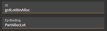

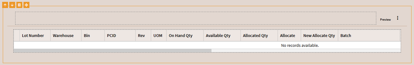

So inside of FulFillment Workbench on the Allocation By Lot / Bin slideout panel I want to default the PartAllocLot.NewAllocatedQty in the grid to PartAllocLot.AvailableQty value.
Which I think is this grid, based on my digging and testing.

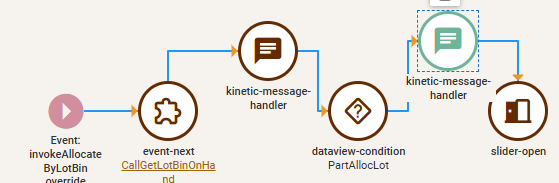

DataView-Conditions are kinda multi-purpose tools. I’ll try to summarize (sorry if it is long winded)…
Use Case One…
Evaluate my dataview and find records (rows) which match my expression/criteria. You can then create branches off of that and perform different actions based on the number of matches.
So, if I have a dataview (set of rows) that I want to evaluate, I can then set up options on what to do next.
OnNoMatch: Take a Nap
OnSingleMatch: Grab the fire extinguisher
OnMultipleMatch: Call the Paw Patrol!
In these “branch” cases… I’m not impacting the results… I’m just taking action based on the number of results (hopefully that makes sense).
Use Case Two…

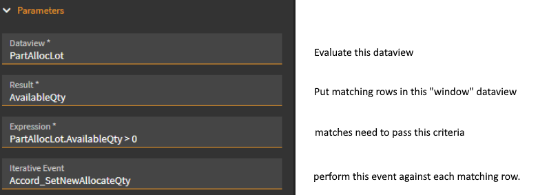

The Iterative event is used when you want to do actions against each row that is put into the result dataset. So, for each row that meets the criteria, perform “this event”.
Here’s a rough explanation of the parameters:
The key thing to keep in mind is that Epicor is not “duplicating” data… your “AvailableQty” (result) dataview is NOT a separate dataset. Its a “window” into the PartAllocLot dataview. It references the same rows in the source dataview.
The iterative event iterates over the result dataview… not the source dataview.
This is why, in your iterative event, when you used PartAllocLot in your bindings, it only referenced the last active row in that dataview. So, all updates were applied using the same value.
By switching your iterative event row-update to reference the AvailableQty view, it then does your row-updates row-by-row, grabbing updated values from AvailableQty.AvailableQty and pushing them to AvailableQty.NewAllocatedQty.
But again, the changes done to this view are ACTUALLY being applied to the source dataview (PartAllocLot).
Anyway… When you use a dataview-condition, you can do branching… an iterative event against the matching rows… or both.
This was an amazing explanation, thank you very much. Okay, so by updating the AvailableQty.NewAllocatedQty will still, in fact, update the PartAllocLot.NewAllocatedQty that is used in the grid.
I am now getting no matching rows LOL
The expression in your dataview condition DOES need to reference the PartAllocLot dataview… that’s the dataview you’re evaluating.
Everything else looks good (at first glance).

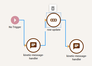

I decided to Error message test like i use to in BPMs and old event code.
Is there a reason why both of those tables would not be matching?

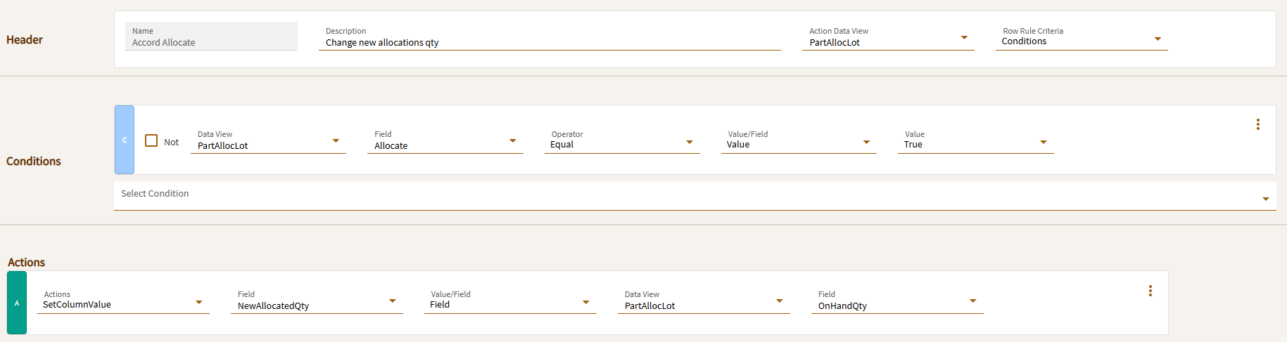

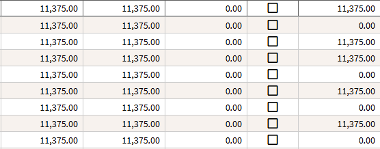

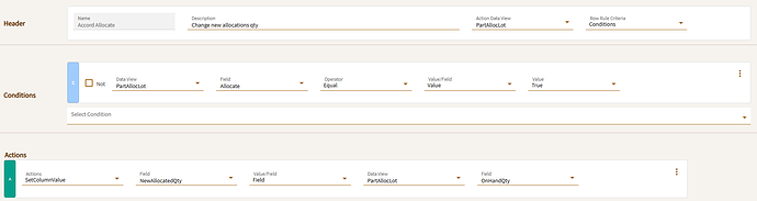

Found a different solution…
