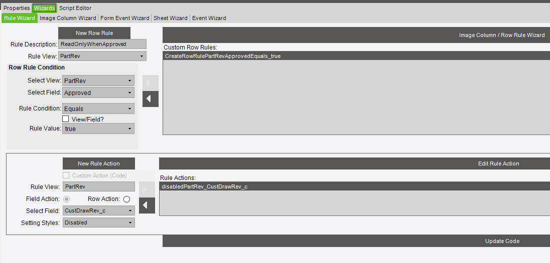

Hey @dena.schmidt , welcome to the forum.
You should be able to do what you want with Row Rules. Go into the help and find the tools user guide under customization and there should be a section that has an explanation on how row rules work. It’s all wizard based so you don’t have to write the code.

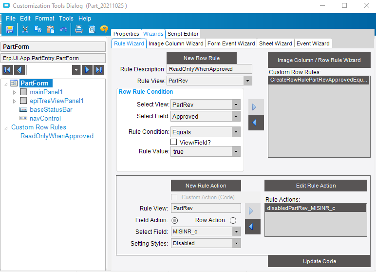

Yep. One quirky thing, though, is that usually EpiReadOnly is the setting style you’d expect to pick in the Rule Action… However, Part Revision is behaving differently than most other forms I’ve worked with. If you select Disabled, it should do what you need. See screen shot below.
Click New Row Rule, fill in the fields, hit the right arrow, then below click New Rule Action, then fill in the fields, hit the right arrow (add as many actions per rule as you need), and then click the Update Code button.

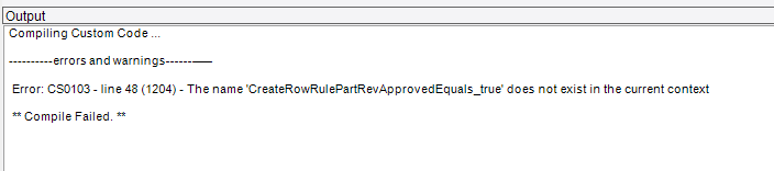

However, I’ve followed steps you provided and it only seems to add 1 line of code and I’m getting a compiling error:
Any ideas?
If you can copy / paste the whole custom code from the script editor, it will be more helpful to identify what went wrong.

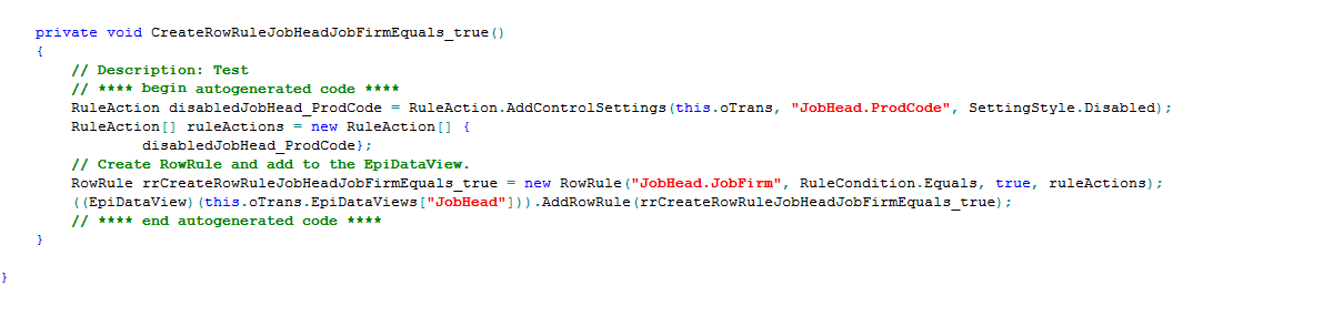

You’re missing the bit that actually does the work. You might try deleting that one line of code, make sure it compiles successfully… and then redo it. I don’t know why but you’re missing this section.
Thanks - yeah that is what I suspected. I have tried deleting that line of code and then recreating rule and selecting update code again and same thing happens. Might try creating a new version of customization and see what happens.
I ended up opening Base form and then creating row rule and it generated code correctly. I then copied the code and updated my customized version and it all works. Thanks for your help!
