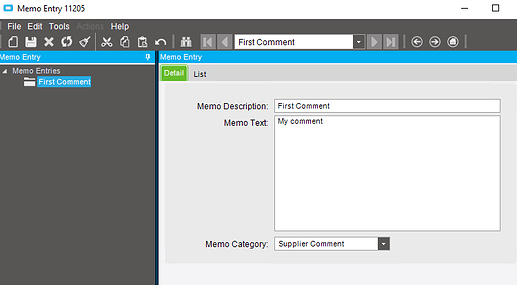

Are you familiar with Memo Entry? It’s available on multiple objects, including Supplier. It allows the user to add comments within separate categories. It tracks the user, date, and time the comment was added.
And since it’s designed for this kind of use, it may be easier to bring the data in than a UD Table and a BAQ. Just a thought.
