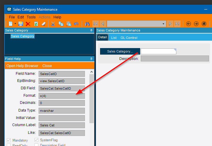

Those are the ID’s of what’s in the drop down? Or that’s the description? It needs to be the ID
EDIT: After looking, yeah that ID is only 4 characters long, so that’s no the right thing to set it to.
