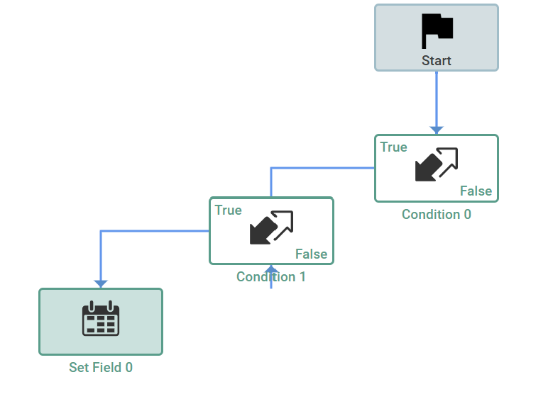

I have the below BPM which is set as a pre-process on Erp.BO,OrderJobWiz.CreateJobs, but something isn’t working.
Condition 0 - Part of the Parts Department
Condition 1 - If BAQ has more than one. BAQ filters to match the partnum from the release partrev with a partrev that has a PARTORDER alternate method
Set field 0 - Set ds.JWOrderRel.DefaultAltMethod field of the changed row to the “PARTORDER” expression.
What am I missing here?

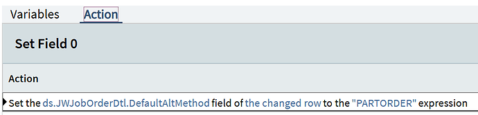

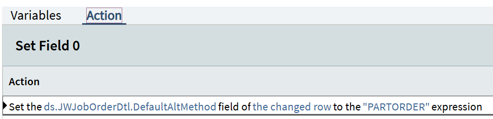

I changed Set Field 0 to
And added another node to update Rowmod to U
I added it, didn’t seem to help.

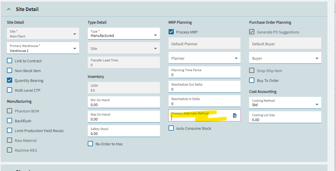

Not sure how it is with service parts, but there is a field on partplant where you can put the primary alternate revision so that when MRP runs it grabs that revision.
I am not sure how manual job creation would work/job creation through order job wizard but maybe just maybe that too checks this field and uses that alternate revision… you’d have to test it out for yourself. See screenshot of the field below:
