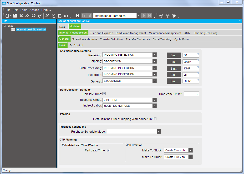

Check your settings in Site Configuration

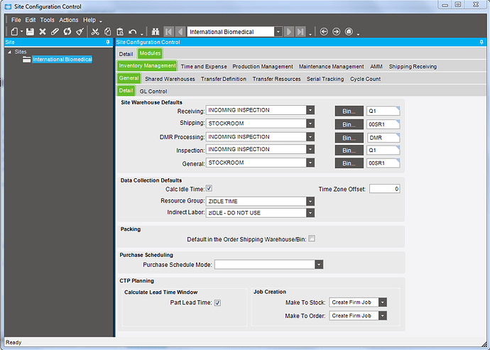

Here’s our warehouse defaults in our Site Configuration. It already pulled the correct value (00SR1) as the default bin when I opened Site Configuration. Am I looking in the right place?
oops, forgot the picture for a moment.
Yes, that is where to look. That was my best guess as to why it was not defaulting anymore. Hopefully you can get a BPM to work.
