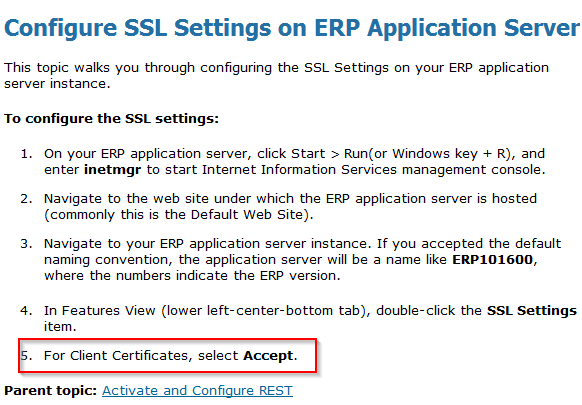

For those who are using REST Services, did you select “Accept” for Client Certificates in the SSL Setting, like configuration instruction tell you to?
If so, did you have to do additional setup of getting a Client Certificate and loading on the Epicor IIS server?
That was a mistake corrected in current docs, apologies.
No need to set that unless you are doing some advanced certificate and identity management (vanilla IIS capabilities). All you need to set in IIS is the server certificate on the box and enable https bindings in the web site.
