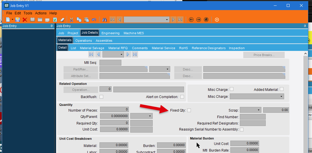

They have a check box on the BOM for a Fixed Qty. That way you can add a certain amount per job, instead of an amount per quantity.
Unfortunately, Epicor only went halfway with that methodology, because you can only do this on materials, and not on assemblies (so to get the laser operations to be the right amount isn’t possible). But at least you could get the materials required for setup added to the BOM/Job.

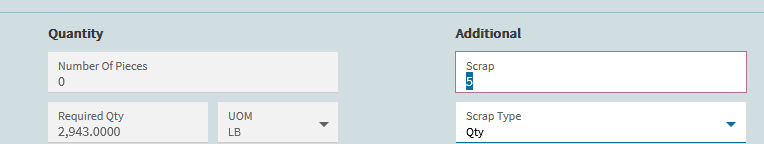

Another addition spot if you are not using % scrap already on the material, you can add it directly to the line using the scrap by piece count directly right of that fixed quantity box or in Kinetic:
