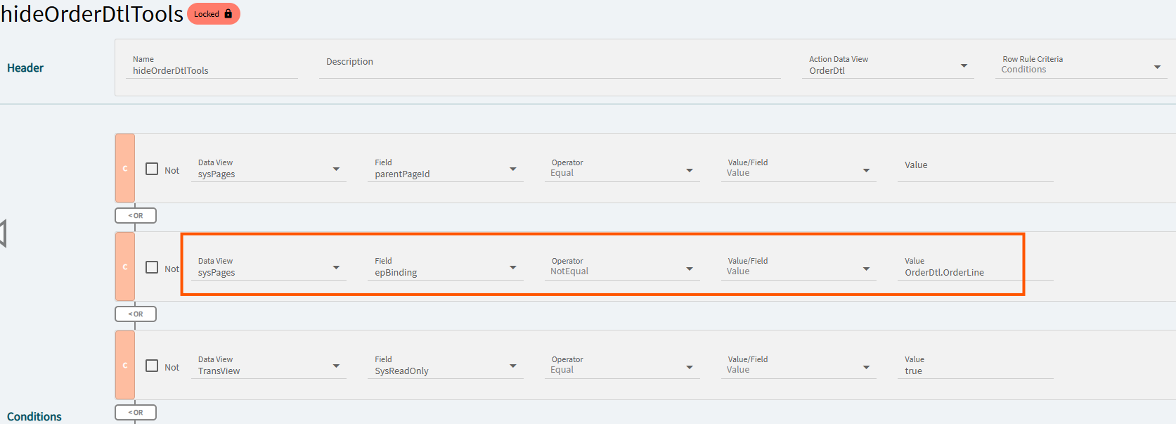

I haven’t tested this, but I saw this used by Epicor in Order Entry just yesterday (I think) and it should work for your case.

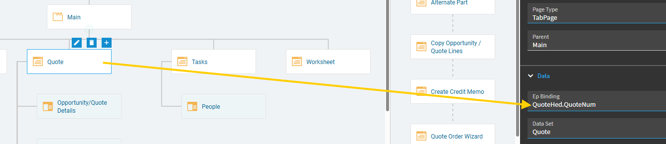

Give your tool a epBinding of QuoteHed.MyKewlTool (or, something less splashy)
Then create a Data Rule mimicking this one:
In your case, the “Active Data View” at the top would be QuoteHed
Your condition would be:
sysPages > epBinding > NotEqual > Value > QuoteHed.QuoteNum
Action mimicking these:
In your case:
SettingStyle.Invisible > Field: MyKewlTool
That should work so if your not on QuoteHed, your tool should be invisible.
If it works, you should be able to follow the same pattern to make your Line level tools invisible if you’re not on a page bound to QuoteDtl.QuoteLine.
brilliant. Works like a charm!
