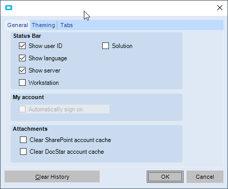

Users will be prompted for their O365 or On-Prem windows password. They can choose to save it but when it comes time to change it, you have to go into Settings | Preferences and clear the account cache:

I thought changing passwords would be an issue when I looked the implementation guide. But I do like being able to see who actually added the attachment. It would be great to have the Clear SharePoint account cache to be enabled when your AD password changed. Not really sure how that would work.

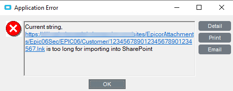

There is also a character limit to the filename, which appears to be 30 characters including the extension. Here is the error.

I believe it’t not the file itself, but the whole URL
Here is some links to some research.
https://blog.wbaer.net/2017/05/09/new-maxpath-limits-in-sharepoint-and-onedrive/
https://tahoeninjas.blog/2019/02/25/sharepoint-migration-mind-the-url-length/
Using the Datestamp option in your sysconfig may tip you over the limit. So beware… I particular if you are dragging and dropping an email in. The subject becomes the filename.
Edit 2:
But I might be wrong. I just looked at the URL for an attachment in error and it was only 139 characters long!
Edit 3
Further investigation by directly copying the file with the altered filename into the SharePoint library works, so…logging a call on this now. Just in case anyone was interested.

Ok there is a Problem for this. PRB0210633
Feel free to mention this in your support calls when attempting to use SharePoint for attachmnts and you have a stupidly long Sharepoint site URL
