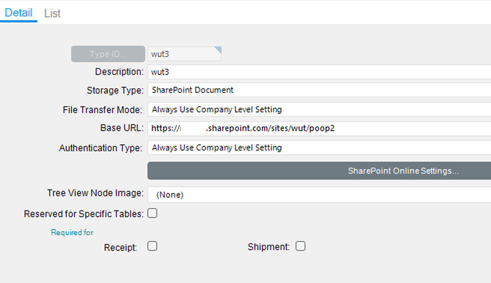

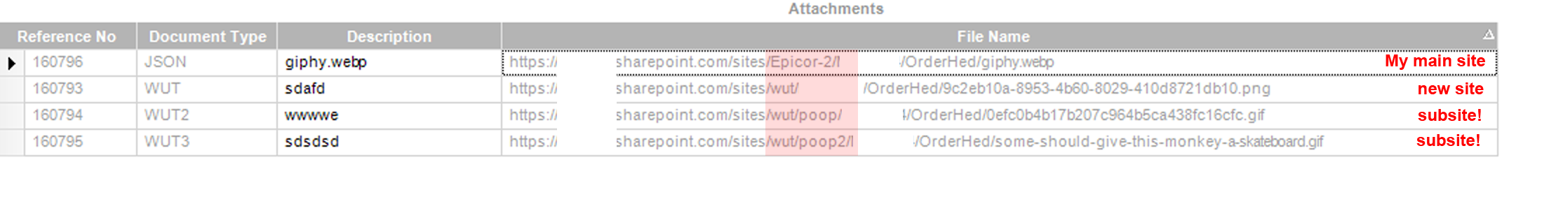

I did this both with a new app registration and without, ie set it up completely new.
The pic has just my company level creds, as they are wide.
But new app, cert, etc works fine.
Sweet! So one ERP Doc Type per library?
I thought only one SPO doc type was allowed or maybe Base URL wasn’t a thing so its made available by the 2024.2 mod.
This really is a big deal that went largely unnoticed as I’m pretty sure it wasn’t a thing in early 2024.
Thanks for sharing!
Oh now I see your paths. Multi-library by virtue of multi-site. Silly they still create and require a library named companyID
But you can do subsites.
Perhaps even sub-subsites.. didn’t test lol.
Yeah it’s huge. Makes Sharepoint infinitely more usable. SPO Security, Teams Sites are now a thing for example. Just don’t like 6-digit doc libs and don’t like folders but yeah full-path Base URL is a big deal.
