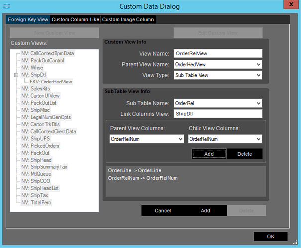

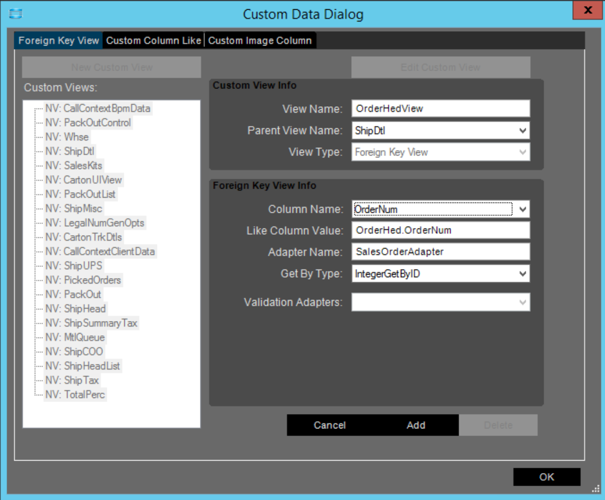

In the customization, you can go to Actions > Data Tools…
In the Foreign Key View and click “New Custom View”. Then add this:
Next, click “New Custom View” again, and add this:
Thank you sir!!!
