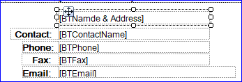

One, is to put each line of the address into its own textbox:
Then you can set the Visibility expression on each box so if it doesn’t have a value, the textbox is hidden and everything below it shifts up.

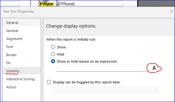

And again, if I’m understanding correctly, you have something like this:
A Label, and a phone number field.
Here is the expression for the phone number field:
If there is no phone number you want to hide the label: Then on the label textbox, add a Visibility expression:
For visibility expressions, you’re providing an arguement where if TRUE, hide the textbox. So in this example, I think it would be:
=iif(Fields!BTConPhone.Value="",true,false)

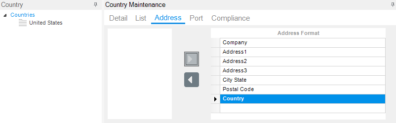

Both @dcamlin and @Hally are spot on here. Kinetic has a really nice built-in system to handle addresses of all formats. New users often make the mistake of entering the addresses in Kinetic in the way they want to see it printed. But Kinetic wants you to define the address pieces separately and then use the Address Format to put them together. This starts with the country:
By default, without a format, you get the fields in the order shown on the form, but you can move these around by filling in this form. In this case, City and State will print on the same line.

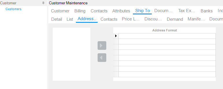

You can override an address format at lower levels like Customer, Ship-To, Supplier, etc.

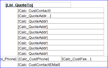

yeah, that’s why you might see reports with stupid, empty textboxes in them like the red one mocked in below:
So if fields are “hidden” things can’t move left, or shrink smaller vertically because there is an object there.
messy.
