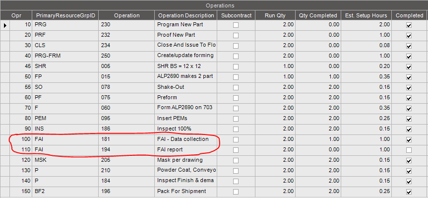

Example: I am using epicor ERP 10.2.700.2 version and have access to the kinetic version too. This is the operations I see on job tracker.

If you right-click on the dark grey line where is says Operations and select Show Grid Filters, you will get a little filter icon next to the column titles. Click on the one next to PrimaryResourceGrpID and scroll the list to find FAI. Click on FAI and it will show only FAI records.
