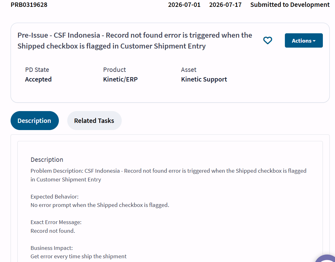

I see this PRB new with 2026. Different error message, but sounds quite similar:

We have one in the UK when we ship it says cant update record sys row ID and after a few refreshes it works does this sound similar ?
