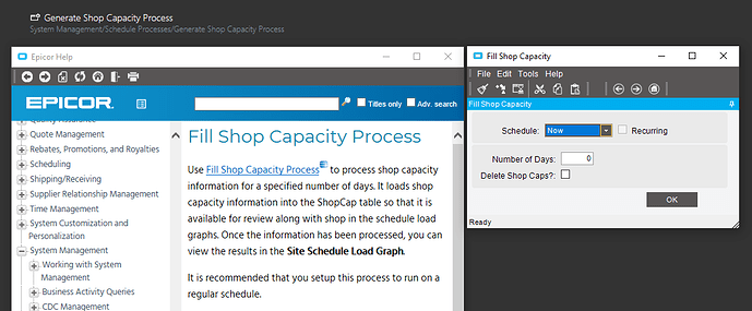

Weâve done some work in this area, and itâs not a simple task. The load hours are âcalculatedâ each run, all the values are not necessarily stored. We wanted to separate âAvailableâ from âExpectedâ, and our contractor had to actually create a new shop load report in order to accomplish that.
No, thatâs shop capacity. We have that running.
