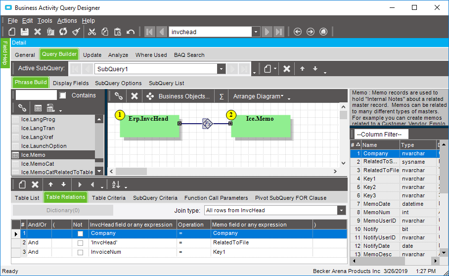

  • Determine whether a memo exists; this is done with a BAQ. Join the InvcHead to Ice.Memo per the screenshot. If the results set has at least one row for your invoice#, a memo exists.
Thanks Paul. Good idea with the BAQ. Just need to figure out how to get it on the screen!
