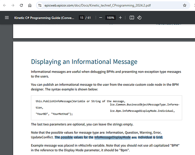

Can anyone up on 2024.2 confirm whether or not the .Grid option works again?
Their 2024.2 C# Programming Guide document still lists it as one of two options for the InfoMessageDisplayMode code.
