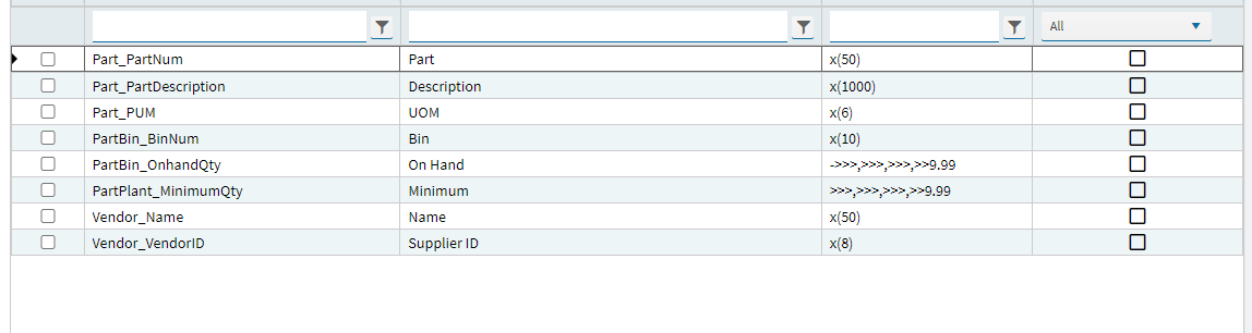

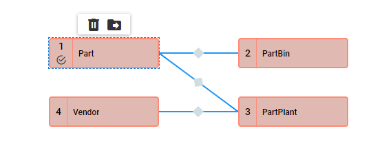

I made a BAQ that is supposed to show items that we need to keep an eye on to see if we need to buy more. The BAQ works great, except that parts that have no inventory are not shown in the results. I did some testing by adding/removing inventory of a part and confirmed that is the reason why the part does not show up. What can I add to make sure that parts with nothing in our inventory will still be shown in the results?

You need to use a left outer join from Part table to the rest.
You see you are using an inner join right now:
That was it! I never knew you could do other types of joins in the BAQ designer, this will be helpful.
