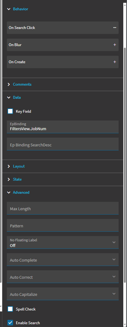

I need to search for the job and I am using Text Box for this. After creation and configuration it looks like this

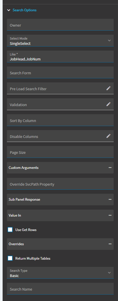

Then I started to work with event On Search Click. I have added search-show widget and configured it like that

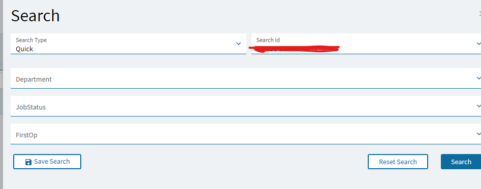

You see that the Search Type is set to Basic but when I run a preview then I got Quick instead
Is this any other setting that is overwriting it?

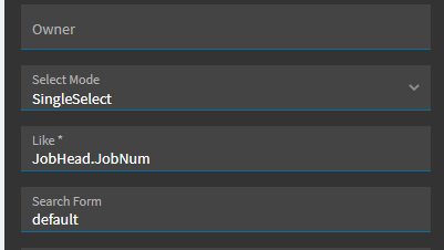

I also tried to put “default” in Search form in the event setup but didn’t help.

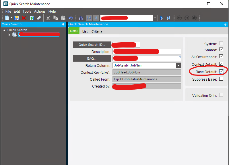

It seems that I have solved it by myself writing this post. Here is where it override the search. For someone else who may struggle in the future with some legacy stuff
